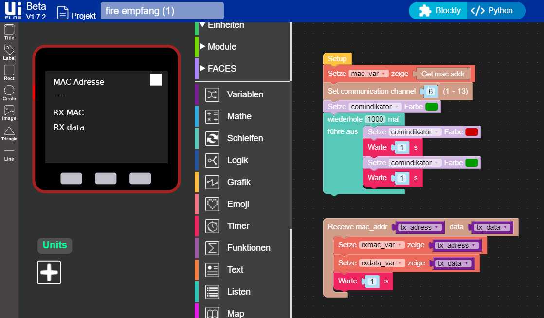

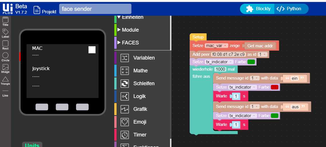

<?xml version="1.0" encoding="UTF-8"?><rss xmlns:dc="http://purl.org/dc/elements/1.1/" xmlns:content="http://purl.org/rss/1.0/modules/content/" xmlns:atom="http://www.w3.org/2005/Atom" version="2.0"><channel><title><![CDATA[ESPNow UIFlow - communication stopps after 10 messages]]></title><description><![CDATA[<p dir="auto">I try ESPNow to connect a M5Stack face to an M5Stack Fire.<br />
Face is sender - Fire is receiver.<br />
This is the send block in Face:<br />
<img src="/assets/uploads/files/1611764909505-face-tx-resized.jpg" alt="0_1611764889538_face tx.jpg" class=" img-fluid img-markdown" /></p>
<p dir="auto">This is the receive block in Fire:<br />
<img src="/assets/uploads/files/1611765037790-fire-resized.jpg" alt="0_1611764963669_fire.jpg" class=" img-fluid img-markdown" /></p>
<p dir="auto">After every send message I'm waiting.</p>
<p dir="auto">It works - but only 10 times.<br />
After the 10 times the received message  is no longer changing.<br />
The programs are working - I can see it on the color change in the small squares.</p>
<p dir="auto">After a new start - again - 10 times chaging the message - then OFF.</p>
<p dir="auto">It feels like a buffer or something like that is full - but -- NO documentation.</p>
<p dir="auto">Can anybody help what's going on in this quit "very complex" software :-)</p>

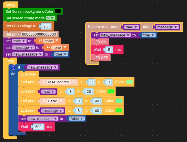

]]></description><link>https://community.m5stack.com/post/12087</link><guid isPermaLink="true">https://community.m5stack.com/post/12087</guid><dc:creator><![CDATA[ramaker]]></dc:creator><pubDate>Thu, 28 Jan 2021 13:04:51 GMT</pubDate></item><item><title><![CDATA[Reply to ESPNow UIFlow - communication stopps after 10 messages on Wed, 27 Jan 2021 18:14:33 GMT]]></title><description><![CDATA[<p dir="auto">In your receive callback function you shouldn't use any time delay, this function should be as short as possible. This callback breaks/pause your main program like interrupt and run yours code. Probably in your case one of this callback "runs" time delay function when next receive callback at this moment run the same code as previous callback.</p>
<p dir="auto">In my case there is a small delay 5ms (but in compare to 1 seconds it is almost nothing)</p>
<p dir="auto">I make some receiver code for stickc, ewentually you make some cosmetic changes.</p>
<p dir="auto"><img src="/assets/uploads/files/1611771102995-block.jpeg" alt="0_1611771091348_block.jpeg" class=" img-fluid img-markdown" /></p>
