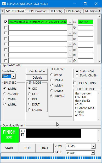

<p dir="auto">but, after M5Cloud-PSRAM rom flashed, does not boot.<br />
(no display, maybe power-on. can hear speaker noise.)</p>
<p dir="auto">rom: m5cloud-psram-20180516-v0.4.0.bin<br />
flash download tool settings:<br />
<img src="/assets/uploads/files/1533530565199-m5stack.jpg" alt="0_1533530556071_m5stack.jpg" class=" img-fluid img-markdown" /></p>
<p dir="auto">any idea?</p>

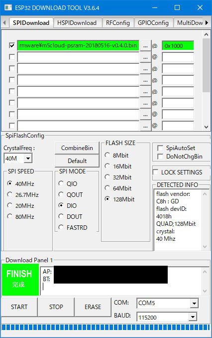

<img src="/assets/uploads/files/1533536249961-m5stack.jpg" alt="0_1533536243117_m5stack.jpg" class=" img-fluid img-markdown" /></p>

<p dir="auto">change SPI MODE:  DIO</p>
<p dir="auto">You tried to burn the PSRAM version firmware in DIO mode. Is PSRAM still not initialized?</p>
]]></description><link>https://community.m5stack.com/post/1374</link><guid isPermaLink="true">https://community.m5stack.com/post/1374</guid><dc:creator><![CDATA[0x1abin]]></dc:creator><pubDate>Mon, 06 Aug 2018 06:06:46 GMT</pubDate></item><item><title><![CDATA[Reply to cannot boot M5Cloud firmware on M5Stack FIRE on Mon, 06 Aug 2018 06:02:37 GMT]]></title><description><![CDATA[<p dir="auto">thank you for replying.<br />
i tried DIO mode and 32Mbit Flash Size, and non PSRAM(m5cloud-20180516-v0.4.0.bin)firmware to boot device.<br />
PSRAM firmware some bug? or my M5Stack FIRE is non 4MB-PSRAM 16MB Flash version?</p>
<p dir="auto">i confused...</p>
]]></description><link>https://community.m5stack.com/post/1373</link><guid isPermaLink="true">https://community.m5stack.com/post/1373</guid><dc:creator><![CDATA[kleus_balut]]></dc:creator><pubDate>Mon, 06 Aug 2018 06:02:37 GMT</pubDate></item><item><title><![CDATA[Reply to cannot boot M5Cloud firmware on M5Stack FIRE on Mon, 06 Aug 2018 05:59:15 GMT]]></title><description><![CDATA[<p dir="auto">change SPI MODE:  <strong>DIO</strong></p>
