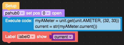

<p dir="auto">not ideal at all but here is a possible work-a-round until this stupid issue has been resolved.</p>
<p dir="auto">The trick is to <strong>not</strong> add the units connected to PaHUB in UiFlow but to initialise them later when PaHUB has selected the respective channel / unit.<br />
In my example the AMeter is connected to PaHUB output 0. Also variable <code>current</code> needs to be defined from within UiFlow.</p>
<p dir="auto"><img src="/assets/uploads/files/1613657086173-m5core2_pahub_ameter_20210218.png" alt="0_1613657081831_M5Core2_PaHub_AMeter_20210218.png" class=" img-fluid img-markdown" /></p>

pahub0 = unit.get(unit.PAHUB, unit.PORTA)
current = None
label0 = M5Label('Text', x=30, y=43, color=0x000, font=FONT_MONT_24, parent=None)
pahub0.select_only_on(0)
myAMeter = unit.get(unit.AMETER, (32, 33))
current = str(myAMeter.current())
label0.set_text(str(current))
</code></pre>
<p dir="auto">Thanks<br />
Felix</p>

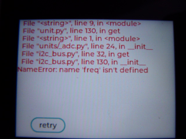

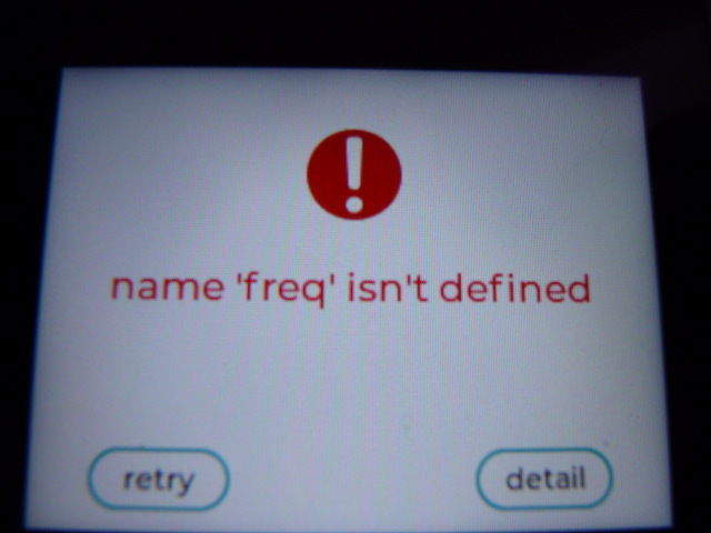

]]></description><link>https://community.m5stack.com/post/12339</link><guid isPermaLink="true">https://community.m5stack.com/post/12339</guid><dc:creator><![CDATA[ajb2k3]]></dc:creator><pubDate>Sat, 06 Feb 2021 09:29:11 GMT</pubDate></item><item><title><![CDATA[Reply to Not possible to connect Pa.HUB on M5Stack CORE2 on Fri, 05 Feb 2021 18:33:22 GMT]]></title><description><![CDATA[<p dir="auto">I have exactly the same error message with my CORE2 connected to a PaHub and an ADC module.<br />
The ADC module works perfectly directly connected to port A of CORE2, but not through the PaHub<img src="/assets/uploads/files/1612549988307-p1110066.jpg" alt="1_1612549860714_P1110066.JPG" class=" img-fluid img-markdown" /> <img src="/assets/uploads/files/1612549988260-p1110067.jpg" alt="0_1612549860714_P1110067.JPG" class=" img-fluid img-markdown" /></p>
