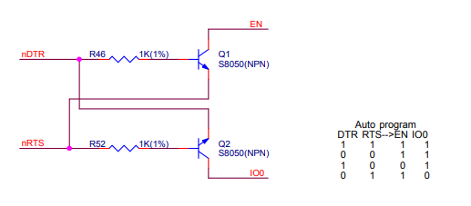

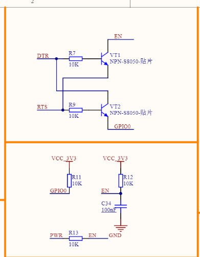

]]></description><link>https://community.m5stack.com/post/1419</link><guid isPermaLink="true">https://community.m5stack.com/post/1419</guid><dc:creator><![CDATA[stoney]]></dc:creator><pubDate>Tue, 21 Aug 2018 14:31:18 GMT</pubDate></item><item><title><![CDATA[Reply to Program M5CAM fails on Tue, 07 Aug 2018 18:10:58 GMT]]></title><description><![CDATA[<p dir="auto">I have been looking a bit closer at this and trying to make sense of it with and I think there is a simple design error but it should still work.</p>
<p dir="auto">this is the WROVER kit control logic ..</p>
<p dir="auto"><img src="/assets/uploads/files/1533664930905-5bdcf38a-6917-40c1-acde-e5b4b92f2dd9-image.png" alt="0_1533664928057_5bdcf38a-6917-40c1-acde-e5b4b92f2dd9-image.png" class=" img-fluid img-markdown" /></p>
<p dir="auto">and this is the M5CAMs</p>
<p dir="auto"><img src="/assets/uploads/files/1533664996440-b21be137-0c34-4baa-8ac1-f3e64c359026-image.png" alt="0_1533664993829_b21be137-0c34-4baa-8ac1-f3e64c359026-image.png" class=" img-fluid img-markdown" /></p>
<p dir="auto">so it looks like VT2 is reversed but it should still work regardless, it might be affecting the timing perhaps ?</p>
<p dir="auto">Using platformio with no mods and the WROVER kit board selected a close look at the reset timing shows that the EN line is always taken high (by about 500nS) after GPIO0 is also taken high, hence it never enters boot mode. I think I can get around it by hacking the <a href="http://esptool.py" target="_blank" rel="noopener noreferrer nofollow ugc">esptool.py</a> .. but its late now, 4am, so it can wait till tomorrow.</p>
