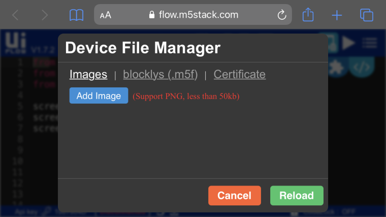

IIRC, M5stack has a limit of 50KB for images. Looks like your image is ~60KB, right? However, why it works with the image stored in flash and not from the SD card, I’m not sure. Can you try to compress the image to under 50KB to see if it works?</p>
<p dir="auto">Edit: Also try converting the image from jpg to png, keeping it under 50KB, to see if it helps.</p>
<p dir="auto"><img src="/assets/uploads/files/1612169542532-9b96338b-b51f-4265-9777-00e19ec9e5c1-resized.png" alt="0_1612169529929_9B96338B-B51F-4265-9777-00E19EC9E5C1.png" class=" img-fluid img-markdown" /></p>
]]></description><link>https://community.m5stack.com/post/12215</link><guid isPermaLink="true">https://community.m5stack.com/post/12215</guid><dc:creator><![CDATA[world101]]></dc:creator><pubDate>Mon, 01 Feb 2021 08:52:26 GMT</pubDate></item><item><title><![CDATA[Reply to [Bug] Core2 loads JPG from flash but crashes with image from micro SD card on Mon, 01 Feb 2021 08:04:00 GMT]]></title><description><![CDATA[<p dir="auto">I checked the image from the micro SD card on my Mac, it seems ok.</p>
