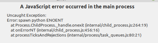

<p dir="auto">PROBLEM 1:<br />
Whenever I click the configuration button in M5Burner, I get the attached error message. <img src="/assets/uploads/files/1612212297256-m5burner_error.png" alt="0_1612212296026_m5burner_error.png" class=" img-fluid img-markdown" /></p>

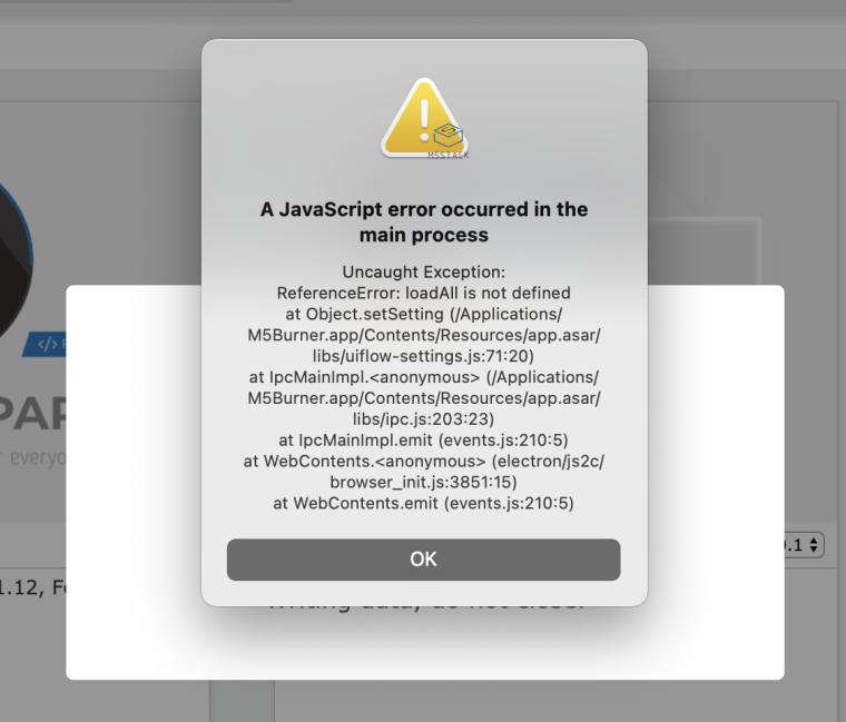

<p dir="auto">Burner V2.2.8<br />
M5Paper V1.7.3.1 and 1.7.4</p>
<p dir="auto"><img src="/assets/uploads/files/1617949689750-bildschirmfoto-2021-04-09-um-07.49.07-resized.png" alt="0_1617949687207_Bildschirmfoto 2021-04-09 um 07.49.07.png" class=" img-fluid img-markdown" /></p>

<p dir="auto"><a class="plugin-mentions-user plugin-mentions-a" href="/user/vlad29" aria-label="Profile: vlad29">@<bdi>vlad29</bdi></a> said in <a href="/post/12965">JavaScript error in M5Burner</a>:</p>
<p dir="auto">I got the same error, it was due to python command doesn't was valid.</p>
<p dir="auto">I had to install "python-is-python3" package (sudo apt-get install python-is-python3) because the app tries using python and not python3.</p>
<p dir="auto">I hope it works.<br />
(making ln to python from python3 should work)</p>
<p dir="auto">Thank you <a class="plugin-mentions-user plugin-mentions-a" href="/user/vlad29" aria-label="Profile: vlad29">@<bdi>vlad29</bdi></a> this is another of those python/python3 issues caused by badly setup python3 installs.</p>
<p dir="auto">You need to look up how to set the enviromental variables in you operating system to stop the os running python 2 commands instead of python3 commands.</p>
<p dir="auto">In the Chromebook Crostini shell (Ubuntu-based VM), I was getting the exact error in this thread.  There is no python-is-python3 package available, but the symlink solved it perfectly:<br />
ln -s /usr/bin/python3 /usr/bin/python</p>
