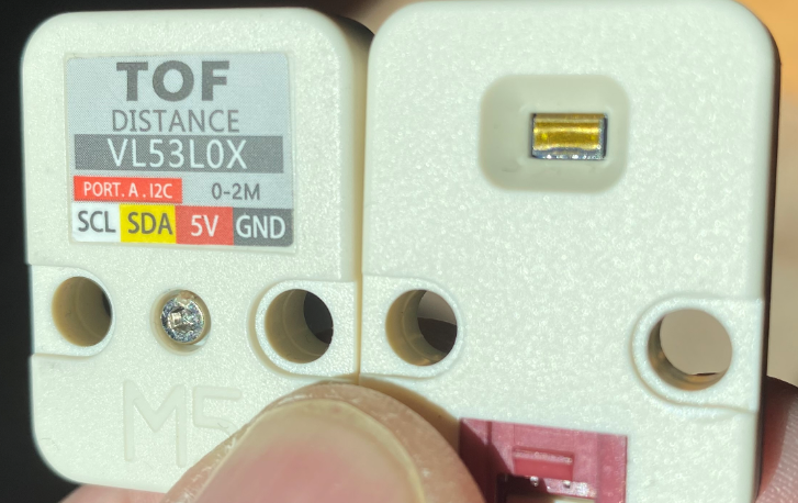

You need to message M5Stack about that as it should have been removed during assembly.</p>
]]></description><link>https://community.m5stack.com/post/12711</link><guid isPermaLink="true">https://community.m5stack.com/post/12711</guid><dc:creator><![CDATA[ajb2k3]]></dc:creator><pubDate>Sun, 28 Feb 2021 08:05:07 GMT</pubDate></item><item><title><![CDATA[Reply to concerns with TOF measurement on Sat, 27 Feb 2021 22:00:57 GMT]]></title><description><![CDATA[<p dir="auto">Hello, I have too problem with the ToF sensor measurement. To solve it I need to removed the protective film from the sensor (unscrew middle screw on the back and remove protective kapton tape from the chip sensor). After this op, the measurement was correct on the full range.</p>
]]></description><link>https://community.m5stack.com/post/12710</link><guid isPermaLink="true">https://community.m5stack.com/post/12710</guid><dc:creator><![CDATA[A1exandr]]></dc:creator><pubDate>Sat, 27 Feb 2021 22:00:57 GMT</pubDate></item><item><title><![CDATA[Reply to concerns with TOF measurement on Sat, 06 Feb 2021 09:49:43 GMT]]></title><description><![CDATA[<p dir="auto">Thank you for the details.<br />
