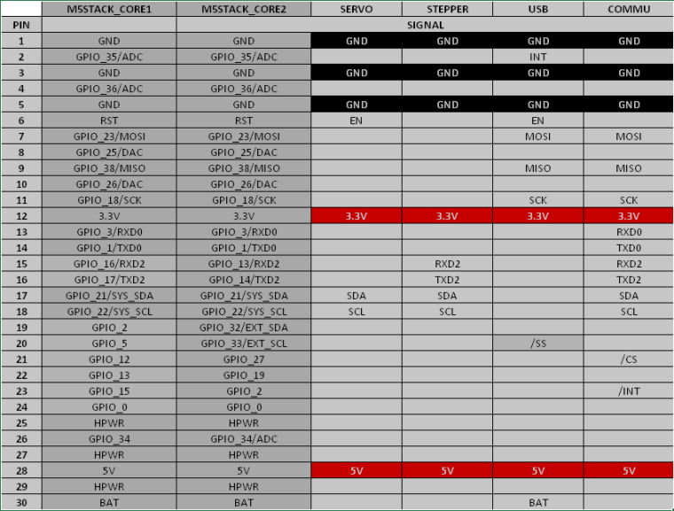

<p dir="auto">some modules have been developed before M5Core2 and are not fully compatible. The reason being that some GPIOs exposed on the M5-Bus have been moved or replaced from where they were on M5Stack (Fire, Base, Gray). A while ago I've made a comparison sheet that might help. You can find it <a href="https://www.gwendesign.com/kb/m5stack/m5core2/#m5core2-bus-and-gpios-compared-to-m5stack" target="_blank" rel="noopener noreferrer nofollow ugc">here</a>.</p>
<p dir="auto">I think the issue with the COMMU module is the CAN interrupt which on M5Stack is connected to GPIO15 but on M5Core2 it is connected to GPIO2. GPIO2 is a so called strapping pin which according to the ESP32 datasheet needs to be <code>low</code> for download mode. However the CAN interrupt (active low) is <code>high</code> when there is no interrupt. That most likely is the reason the ESP32 is kept from going into download mode.</p>
<p dir="auto">Without a hardware change I am afraid you'll need to un-stack the COMMU module every time you want to download new firmware.</p>
