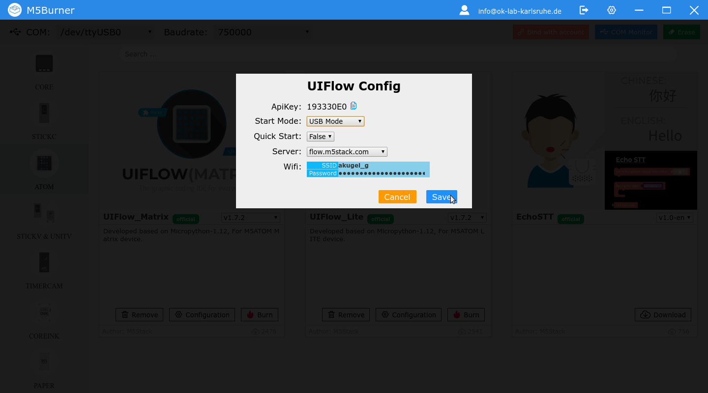

Ich can erase and flash the bootloader. The WiFi dialog on flashing works. But I cannot set config options to USB mode which is needed to use the desktop IDE.<br />
<img src="/assets/uploads/files/1613142954953-usb1-resized.png" alt="0_1613142950330_usb1.png" class=" img-fluid img-markdown" /></p>

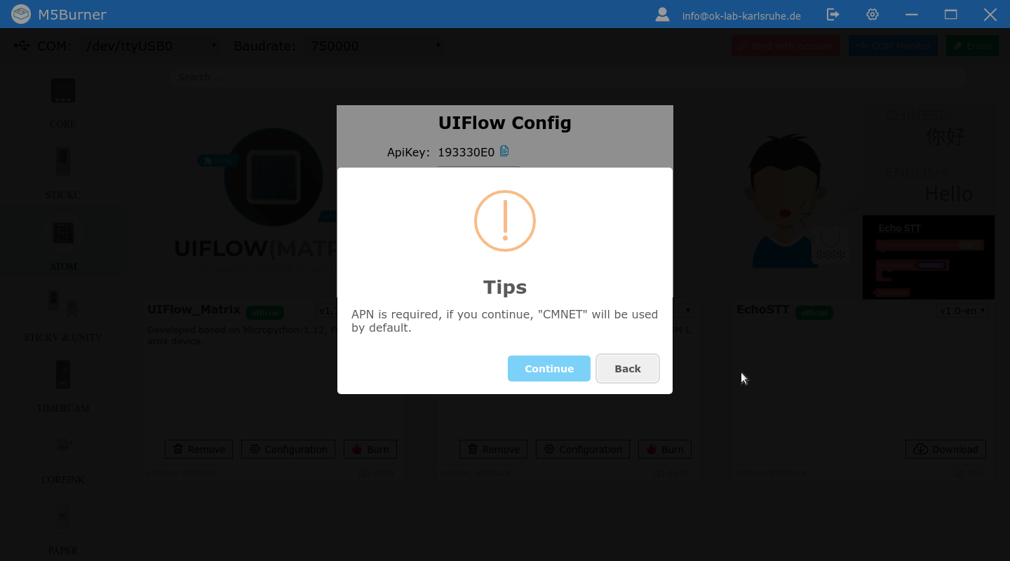

<p dir="auto">First, there is a strange message about "setting APN required"<br />
<img src="/assets/uploads/files/1613142954894-usb2-resized.png" alt="1_1613142950331_usb2.png" class=" img-fluid img-markdown" /></p>
<p dir="auto">then javascript error: "loadall is not defined".<br />
<img src="/assets/uploads/files/1613142954822-usb3.png" alt="2_1613142950331_usb3.png" class=" img-fluid img-markdown" /></p>

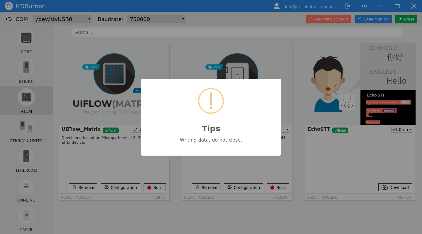

<p dir="auto">After that, M5burner shows the message "writing data, do not close" but no activity any more.<br />
<img src="/assets/uploads/files/1613142955010-usb4-resized.png" alt="3_1613142950331_usb4.png" class=" img-fluid img-markdown" /></p>
<p dir="auto">How can I set the device to usb mode? Can I do this via  <a href="http://esptool.py" target="_blank" rel="noopener noreferrer nofollow ugc">esptool.py</a> alone, without the m5burner GUI?</p>

]]></description><link>https://community.m5stack.com/post/17132</link><guid isPermaLink="true">https://community.m5stack.com/post/17132</guid><dc:creator><![CDATA[ajb2k3]]></dc:creator><pubDate>Fri, 08 Apr 2022 05:08:18 GMT</pubDate></item><item><title><![CDATA[Reply to M5Burn cannot set option to USB-mode for local UIFlow-IDE on Thu, 07 Apr 2022 22:55:01 GMT]]></title><description><![CDATA[<p dir="auto"><a class="plugin-mentions-user plugin-mentions-a" href="/user/world101" aria-label="Profile: world101">@<bdi>world101</bdi></a> I'm having the same problem... this page only seems to give the method of getting the Atom Matrix into offline mode... I have the Atom Lite... I've tried holding the middle button on startup and the LED never goes blue... just green...</p>
]]></description><link>https://community.m5stack.com/post/17129</link><guid isPermaLink="true">https://community.m5stack.com/post/17129</guid><dc:creator><![CDATA[davelondon]]></dc:creator><pubDate>Thu, 07 Apr 2022 22:55:01 GMT</pubDate></item><item><title><![CDATA[Reply to M5Burn cannot set option to USB-mode for local UIFlow-IDE on Sat, 13 Feb 2021 09:22:17 GMT]]></title><description><![CDATA[<p dir="auto">This page shows how to put the Atom Matrix/Lite into USB (Desktop) mode.</p>
<p dir="auto"><a href="https://docs.m5stack.com/#/en/quick_start/atom/atom_quick_start_uiflow" target="_blank" rel="noopener noreferrer nofollow ugc">https://docs.m5stack.com/#/en/quick_start/atom/atom_quick_start_uiflow</a></p>
<p dir="auto">“Press and hold the middle button while powering on (or when restarting), and do not release it until LED color change to blue.“</p>
