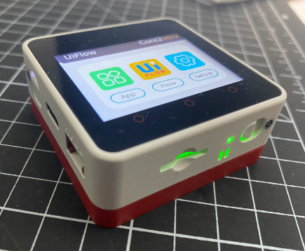

but I prefer the <a href="https://m5stack.com/products/m5go-battery-bottom2-for-core2-only?_pos=10&amp;_sid=3558bfcc2&amp;_ss=r" target="_blank" rel="noopener noreferrer nofollow ugc">M5GO2</a>, because it adds a port B and C <img src="/assets/uploads/files/1613670790405-m5stack.png" alt="0_1613670758833_M5STACK.PNG" class=" img-fluid img-markdown" /></p>
