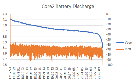

<p dir="auto">the most accurate and lightweight solution would be a lookup table. It could mimick that curve exactly at every percentage point using only 100 float values - and a very simple function:</p>
<p dir="auto">Actually I could do it using a handful of float "keyframes" at key points and calculate an interpolated percentage on the fly. Which is better - less ram / sketch ram? Or less CPU ticks? I would normally just burn a full lookup table to free up clockticks but memory can be a valuable resource too....</p>
<p dir="auto">100 * 4 bytes = 400 bytes + headers of sketch ram for the full lookup table.</p>
<p dir="auto">I could probably reduce this to 100 bytes but at a realtime processing cost (which will cost battery!). I'm leaning on the full lookup table idea.</p>
]]></description><link>https://community.m5stack.com/post/12778</link><guid isPermaLink="true">https://community.m5stack.com/post/12778</guid><dc:creator><![CDATA[Pensive]]></dc:creator><pubDate>Wed, 03 Mar 2021 22:45:56 GMT</pubDate></item><item><title><![CDATA[Reply to Core2 how to know the current battery level on Wed, 03 Mar 2021 22:35:39 GMT]]></title><description><![CDATA[<p dir="auto"><a class="plugin-mentions-user plugin-mentions-a" href="/user/jimwsmith" aria-label="Profile: jimwsmith">@<bdi>jimwsmith</bdi></a> said in <a href="/post/12766">Core2 how to know the current battery level</a>:<br />
As you can see the line is reasonably linear until the very end.</p>
<p dir="auto">Great thank you! It's the super steep drop off at the end that is messing with everything as the algorithm in the example code just draws a straight line from 3.2v to 4.2v so up until the steep drop off it says you have almost 50% more battery than you actually have! at that dropoff point the voltage is about 3.65v - so the percentage calculation at that point in the graph will read 45%!!!</p>
<p dir="auto">I've observed the same phenomenon in reverse when charging - it looks like you are charging really quickly because you hit 45% really quickly then it takes forever to make it the rest of the way - no wonder - you're only 20% charged!</p>
<p dir="auto">byte returnBatteryLevel(float currentVoltage){}</p>
<p dir="auto"><a class="plugin-mentions-user plugin-mentions-a" href="/user/jimwsmith" aria-label="Profile: jimwsmith">@<bdi>jimwsmith</bdi></a> would you be willing to share that spreadsheet with me so I can pull the voltages out? I'd be happy to commit this function back to the M5core2 master so we can all report (more) accurate percentages.</p>
<p dir="auto"><a class="plugin-mentions-user plugin-mentions-a" href="/user/revta" aria-label="Profile: revta">@<bdi>revta</bdi></a> getting to a projected time left would be a step 2 in this process - the first being getting an accurate percentage left, the second projecting how <em>quickly</em> this will diminish based on knowlegde of the battery and the current draw. I think this part is getting much more complicated as it will be drastically affected by different battery capacities (Faces kit or the battery stack units etc.) as well as the current draw - this is not so much the case with Step 1 so step 1 would be much more universal function and I think will remain reasoably accurate across battery capacities.</p>

<img src="/assets/uploads/files/1614757535901-e56dc049-31ba-49d9-b580-958689ba2c4e-image.png" alt="0_1614757533504_e56dc049-31ba-49d9-b580-958689ba2c4e-image.png" class=" img-fluid img-markdown" /></p>

<p dir="auto">Thank you for running that test! I thought that's how it worked but didnt have time to get around testing it. The idea I had was to integrate either the time on or approx consumption and store it using the "preferences" library. The library saves whatever to the non-volatile memory so you wouldnt need the SD card. There was a write up of the libaray on the forums here:</p>
<p dir="auto"><a href="https://community.m5stack.com/topic/1496/storing-settings-in-the-memory-of-the-core">https://community.m5stack.com/topic/1496/storing-settings-in-the-memory-of-the-core</a></p>
<p dir="auto">So the two ideas:</p>
<ol>
<li>
<p dir="auto">track how long the device has been on, update a preference with the time, subtract time on from the 5 hours 40 mins to get time remaining. It wont always be accurate, but probably close enough for most uses.</p>
</li>
<li>
<p dir="auto">Calculate the current consumption based on screen/wifi/bluetooth/etc being on, integrate all that and compare to total mah of the battery. (This would have a lot of factors, but could probably get you closer if you figured all them out.)</p>
</li>
</ol>
<p dir="auto">I think the first one is the "easiest", do you have any thoughts?</p>
