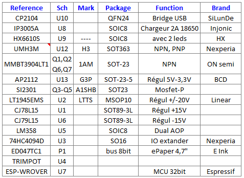

      bill of materials most complete
      SYL

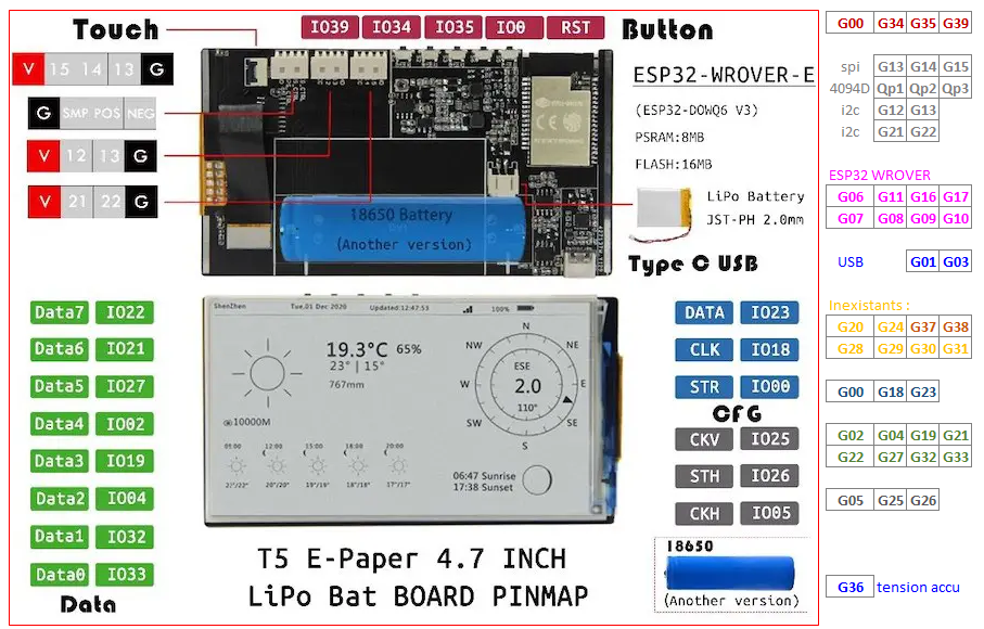

          74HC4094D, IO extander, needs many pins
          ESP32-D0WD => 48 pin (m5paper)
          ESP32-C3-FH4 => 32 pin, with 4 Mo flash only
          ESP32-WROVER => 38 pin (LilyGo), with 16 Mo Flash and 8 Mo SDRAM
          ESP32-S2-FN4R2 => 56 pin, with 4 Mo flash and 2 Mo SDRAM integrated

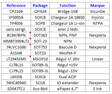

          • B Offline
            bricox @bricox
            @bricox
            Touch connector most complete

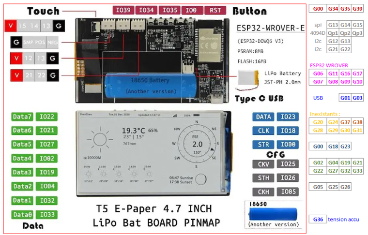

                          Also, my TTGO T5 4.7 arrived, finally. Overall, a nice piece, although a bit rough around the edges compared to the M5Paper. Overall, the PCB seems to be better designed, everything is nicely sectioned apart. But, LilyGO did bum it up, the EPD connector is just sliiiiightly further from the edge than the ribbon itself, which results in some twisting of the cables, and I'm not sure I'm comfortable with it...
                          One thing I'm extremely unhappy with is the battery connector. I opted for the 18650 model (the difference is literally just the connector soldered - with a J2 female connector and 5 minutes of soldering I could convert it easily, but I want to use it with 18650 batteries for easy battery swapping), and the metal wings are outrageously bad quality. They are too rigid, and the edges were not finished properly, and I managed to cut open the wrap of one of my cells on the first insert. This was with great attention paid to the insertion process, and ~3 hours spent on filing down the connector edges (don't worry, I covered the rest of the board with painter's tape, and blasted it with some compressed air to make sure no metal fragments linger around). I think once I have a finalised 3D printed case for it, I'll remove the connector and replace it with a homemade spring-loaded version.
