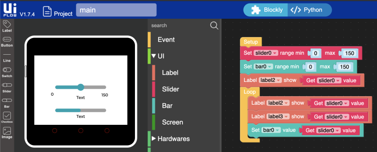

]]></description><link>https://community.m5stack.com/post/13291</link><guid isPermaLink="true">https://community.m5stack.com/post/13291</guid><dc:creator><![CDATA[Arno]]></dc:creator><pubDate>Sun, 28 Mar 2021 16:13:33 GMT</pubDate></item><item><title><![CDATA[Reply to The Max value of the slider cannot be modified ! on Sun, 28 Mar 2021 13:22:25 GMT]]></title><description><![CDATA[<p dir="auto">Yes, I agree this is a bug with the slider object and also the bar object in the UI simulator, but you can easily work around the bug with the <code>Set range min max</code> block until m5stack fixes it.</p>
<p dir="auto"><img src="/assets/uploads/files/1616937689763-screen-shot-2021-03-28-at-9.20.51-am-resized.png" alt="0_1616937679092_Screen Shot 2021-03-28 at 9.20.51 AM.png" class=" img-fluid img-markdown" /></p>
