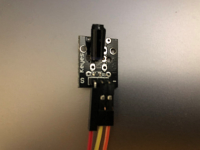

<?xml version="1.0" encoding="UTF-8"?><rss xmlns:dc="http://purl.org/dc/elements/1.1/" xmlns:content="http://purl.org/rss/1.0/modules/content/" xmlns:atom="http://www.w3.org/2005/Atom" version="2.0"><channel><title><![CDATA[(SOLVED) Help Needed: Keys KY-031 Knock Sensor Module connection to M5Stack Core]]></title><description><![CDATA[<p dir="auto">I'm trying to connect this module to my M5Stack Core.</p>
<p dir="auto">Description<br />
KY-031 knock sensor module. A vibration sensor that sends a signal when a knock/tap is detected.</p>
<p dir="auto">Compatible with Arduino, ESP8266, ESP32, Teensy, Raspberry Pi, and other popular platforms.</p>
<p dir="auto">KY-031 Knock Sensor Module<br />
KY-031 Specifications<br />
This module consists of a 10 kΩ resistor and a spring-based sensor that sends a high signal when a vibration is detected.</p>
<p dir="auto">Operating Voltage	3.3V to 5V<br />
Output Type	Digital<br />
KY-031 Connection Diagram<br />
Connect the module's Power line (middle) and the ground (-) to +5 and GND respectively. Connect signal (S) to pin 3 on the Arduino.</p>
<p dir="auto">KY-031	Arduino<br />
S	Pin 3<br />
middle	+5V<br />
-GND</p>
<p dir="auto">On the Arduino it uses Pin 3. What Pin should I use on the M5Stack?</p>
<p dir="auto">Thanks in advance,</p>
<p dir="auto">WW</p>

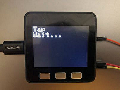

<p dir="auto">On that particular module I connected it as follows:</p>
<p dir="auto">Left pin on module labeled 'S' to 5v on the righthand side of M5Stack (red wire)<br />
Center pin on module (not labeled) to GND on the righthand side of M5Stack (yellow wire)<br />
Right pin on module labeled '--' to pin 2 on the righthand side of the M5Stack (orange wire)<br />
After you compile and upload the app tap the module to see the "Tap" message.</p>
