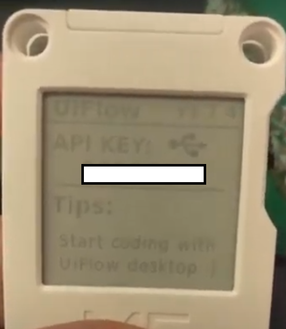

<p dir="auto">I thought that ePaper kept the last drawing despite power off.</p>
<p dir="auto">My screen ink starts to fade away and gets dim grey in less than 3 seconds after I press the reset button. Is it the expected behavior or I have a faulty unit?</p>
<p dir="auto">Thanks!</p>

]]></description><link>https://community.m5stack.com/post/13471</link><guid isPermaLink="true">https://community.m5stack.com/post/13471</guid><dc:creator><![CDATA[ajb2k3]]></dc:creator><pubDate>Sun, 11 Apr 2021 06:48:52 GMT</pubDate></item><item><title><![CDATA[Reply to Core Ink screen fades on reset on Fri, 09 Apr 2021 10:58:10 GMT]]></title><description><![CDATA[<p dir="auto">A reset will trigger a power cycle, which in turn resets the SPI connection to the e-ink display. The display has a controller built-in, which at this point is also power cycled, and most likely runs the initialisation of the screen. So when you press the reset button, the display thinks it needs to get into a "ready for new data" state, which is why it "fades".</p>
<p dir="auto">If you want to work this around, I'd recommend storing the screen contents every time you write to the screen, to storage that is preserved during a power cycle (basically, dump that 200x200 4b array onto the flash), and make sure that your startup handling "updates" the screen with that content immediately after the device is initialised.</p>

<p dir="auto">when run from battery a reset (cut power) is not the same as a shutdown (power off). I see the same fading when I reset my M5CoreInk with the reset button on the back. However when I do a shutdown (programmatically) the content on the screen stays and doesn't fade away.</p>
<p dir="auto">Note: In UIFlow you can use <code>Power - Power off</code> to do the shutdown.</p>
<p dir="auto">Thanks<br />
Felix</p>

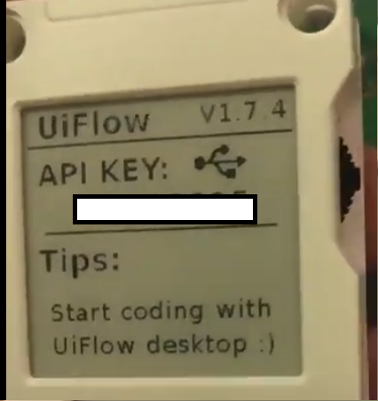

<img src="/assets/uploads/files/1617825467344-299d778a-5e5e-42ff-b318-d565056118bf-image.png" alt="0_1617825465753_299d778a-5e5e-42ff-b318-d565056118bf-image.png" class=" img-fluid img-markdown" /></p>
