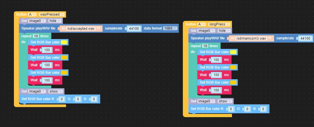

<p dir="auto">In this blockly code, it does not appear to knwo the difference between a button a press and a button a long press.</p>
<p dir="auto">When button A is pressed, it does the steps in Button A pressed , then the steps in button A long press. Nothing I have tried makes it do only the long press block.</p>
<p dir="auto"><img src="/assets/uploads/files/1618262767927-capture2-resized.jpg" alt="0_1618262762555_Capture2.JPG" class=" img-fluid img-markdown" /></p>

]]></description><link>https://community.m5stack.com/post/19816</link><guid isPermaLink="true">https://community.m5stack.com/post/19816</guid><dc:creator><![CDATA[mchott]]></dc:creator><pubDate>Tue, 10 Jan 2023 20:03:37 GMT</pubDate></item><item><title><![CDATA[Reply to Blocky does not seem to differentiate between button a pressed and button a long press on Thu, 15 Apr 2021 08:01:50 GMT]]></title><description><![CDATA[<p dir="auto">Hello <a class="plugin-mentions-user plugin-mentions-a" href="/user/delchi" aria-label="Profile: Delchi">@<bdi>Delchi</bdi></a></p>
<p dir="auto">have you tried to use <code>wasReleased</code> and <code>longPress</code> instead?</p>
