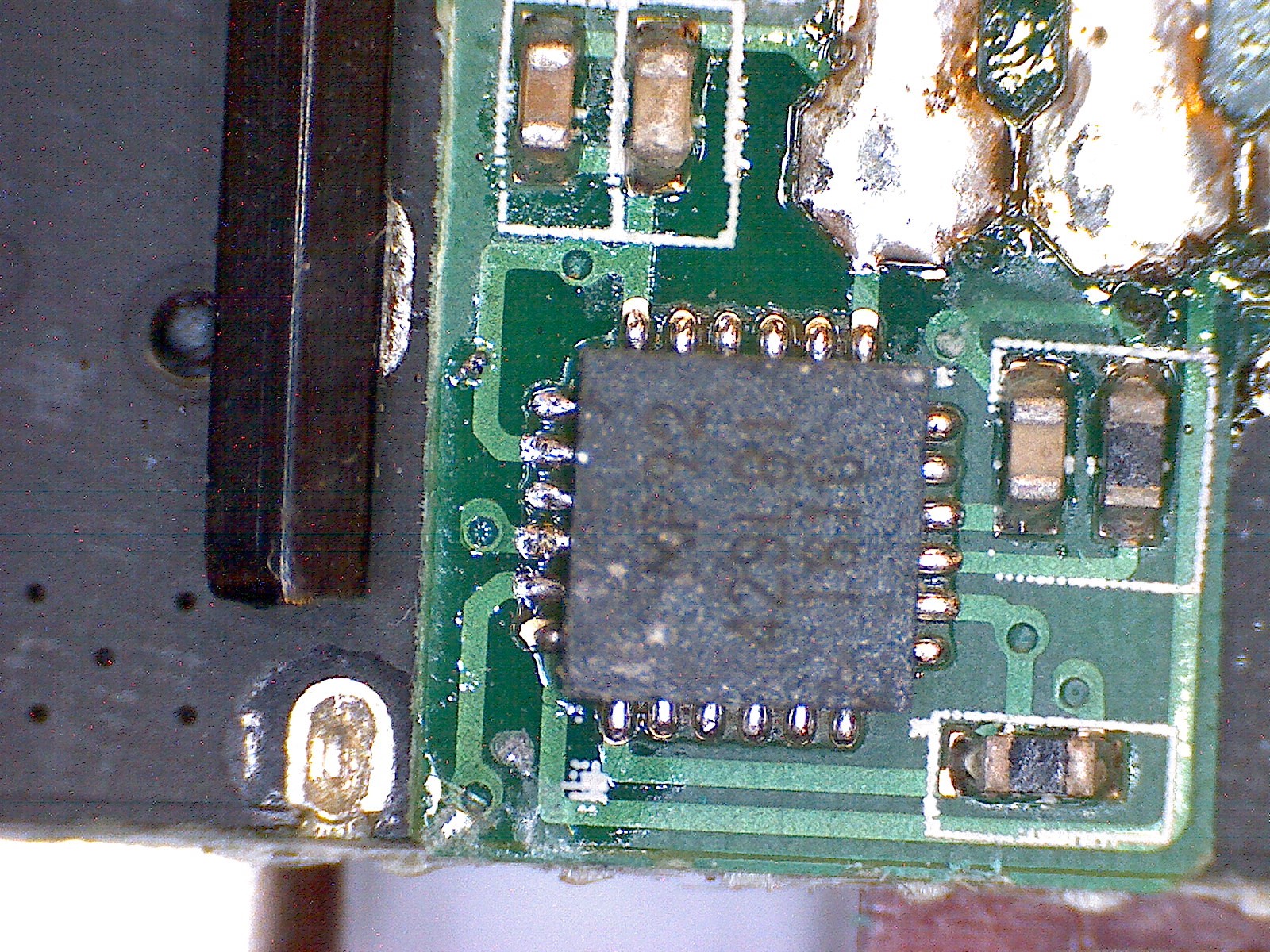

<p dir="auto">thanks for the info on your M5Stack tuning. I opened the case and managed to get to the MPU9250 however, I am quite sure that I would burn something considering the tools I have. I took a photo of the MPU9250 with the 1.5mm Allen key next to it just to give an impression of size.<br />
<img src="/assets/uploads/files/1619535256712-win_20210427_15_28_44_pro-resized.jpg" alt="0_1619535245194_WIN_20210427_15_28_44_Pro.jpg" class=" img-fluid img-markdown" />  I have purchased some ADXL355Z and will try a "conventional" solution. BTW, to open the case I followed the instructions given here (<a href="https://forum.m5stack.com/topic/257/replace-cracked-screen/6" target="_blank" rel="noopener noreferrer nofollow ugc">https://forum.m5stack.com/topic/257/replace-cracked-screen/6</a>).</p>

<p dir="auto">my M5Stack Gray (which uses an MPU6886) did not have the interrupt connected to ESP32. I assume that is the case with your (earlier) M5Stack Gray version as well.</p>
<p dir="auto">That said, here is how I connected the missing <a href="https://gwendesign.ch/kb/m5stack/m5stack/#wake-on-motion-wom-using-mpu6886-interrupt" target="_blank" rel="noopener noreferrer nofollow ugc">interrupt wire</a>.</p>
