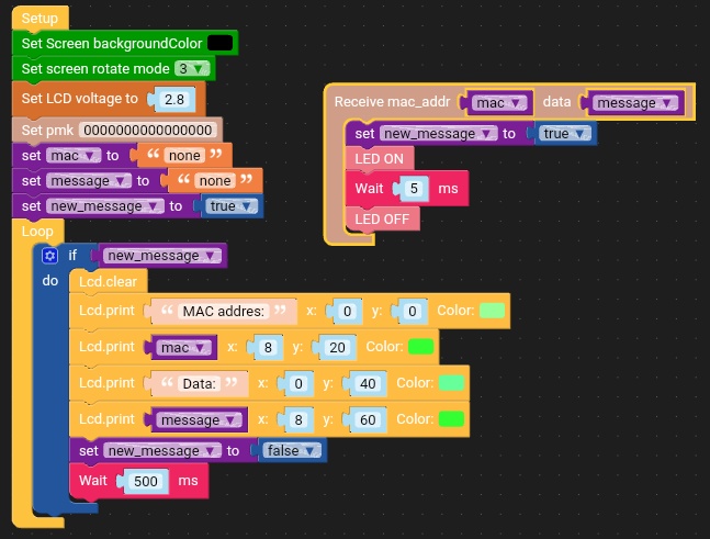

]]></description><link>https://community.m5stack.com/topic/3219/esp-now-between-gray-core-and-stick</link><generator>RSS for Node</generator><lastBuildDate>Wed, 29 Apr 2026 11:29:02 GMT</lastBuildDate><atom:link href="https://community.m5stack.com/topic/3219.rss" rel="self" type="application/rss+xml"/><pubDate>Fri, 23 Apr 2021 07:16:01 GMT</pubDate><ttl>60</ttl><item><title><![CDATA[Reply to esp now between gray core and stick on Sat, 24 Apr 2021 17:02:58 GMT]]></title><description><![CDATA[<p dir="auto">I use this code in stickc as esp receiver for debug. And on other atom lite i use only <strong>broadcast data</strong>block with <strong>convert to str</strong> block with my message. And its works.</p>
<p dir="auto"><img src="/assets/uploads/files/1619283750745-block.jpeg" alt="0_1619283747147_block.jpeg" class=" img-fluid img-markdown" /></p>

<p dir="auto">Insert the “Add peer...” block in the Setup and put the MAC address of the other device into the block for each program.</p>
