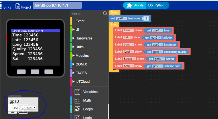

]]></description><link>https://community.m5stack.com/topic/3269/gps-at6558-at-thonny-editor</link><generator>RSS for Node</generator><lastBuildDate>Wed, 29 Apr 2026 08:44:01 GMT</lastBuildDate><atom:link href="https://community.m5stack.com/topic/3269.rss" rel="self" type="application/rss+xml"/><pubDate>Sat, 08 May 2021 05:42:50 GMT</pubDate><ttl>60</ttl><item><title><![CDATA[Reply to GPS (AT6558) at Thonny editor on Sun, 09 May 2021 01:47:12 GMT]]></title><description><![CDATA[<p dir="auto">Hi, In GRAY M5STACK unfortunatelly PortA is used for I2C to some internal chip. Sometime GPS not work on Grove Cable.</p>
<p dir="auto">Just connect GPS to<br />
16RX &lt;&lt;&lt; TX White<br />
17TX &gt;&gt;&gt; Rx Yellow<br />
And all start working with no problem.</p>
<p dir="auto">Example code from Arduino works if You add</p>
<p dir="auto">#define RX1 16<br />
#define TX1 17<br />
...<br />
void setup()<br />
{<br />
M5.begin();<br />
M5.Power.begin();<br />
GPSRaw.begin(9600, SERIAL_8N1,RX1,TX1);</p>
