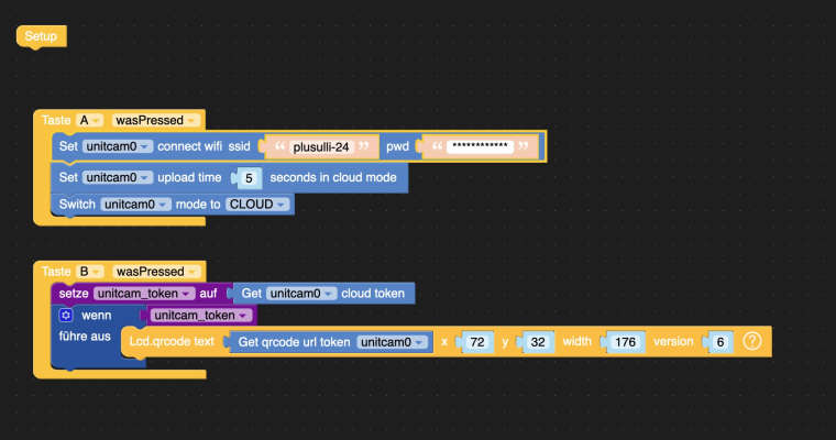

To your questions</p>
<ol>
<li>
<p dir="auto">my device has no problem</p>
</li>
<li>
<p dir="auto">my SSID and password are correct and there are no special characters in them.</p>
</li>
<li>
<p dir="auto">why the question about the UIFlow version when it should only be possible with version V1.7.8?</p>
</li>
</ol>

<li>check your device's connection is not a problem.</li>
<li>if using the UART mode is works,   you should check to enter SSID and password are right. (don't include any special char)</li>
<li>which UIFlow firmware version are you used? after you run the program.  did you get any errors?</li>
</ol>

<img src="/assets/uploads/files/1623244257491-bildschirmfoto-2021-06-09-um-15.07.44-resized.jpg" alt="0_1623244254572_Bildschirmfoto 2021-06-09 um 15.07.44.jpg" class=" img-fluid img-markdown" /></p>
]]></description><link>https://community.m5stack.com/post/14059</link><guid isPermaLink="true">https://community.m5stack.com/post/14059</guid><dc:creator><![CDATA[plusulli]]></dc:creator><pubDate>Wed, 09 Jun 2021 13:17:57 GMT</pubDate></item><item><title><![CDATA[Reply to UNITCAM Problem on Tue, 08 Jun 2021 10:45:32 GMT]]></title><description><![CDATA[<p dir="auto"><a class="plugin-mentions-user plugin-mentions-a" href="/user/plusulli" aria-label="Profile: plusulli">@<bdi>plusulli</bdi></a> said in <a href="/post/13904">UNITCAM Problem</a>:</p>
<p dir="auto">have entered the SSID and password of my wifi in the block.<br />
That's all I can do. Where should I tap the serial log?</p>
<p dir="auto">Hi.  we already test the service.  it works.  could you paste your code here? that would very helpful for us to position the issues.</p>
]]></description><link>https://community.m5stack.com/post/14033</link><guid isPermaLink="true">https://community.m5stack.com/post/14033</guid><dc:creator><![CDATA[m5stack]]></dc:creator><pubDate>Tue, 08 Jun 2021 10:45:32 GMT</pubDate></item><item><title><![CDATA[Reply to UNITCAM Problem on Tue, 08 Jun 2021 02:02:18 GMT]]></title><description><![CDATA[<p dir="auto"><a class="plugin-mentions-user plugin-mentions-a" href="/user/m5stack" aria-label="Profile: m5stack">@<bdi>m5stack</bdi></a> How would you see the serial print log?</p>
