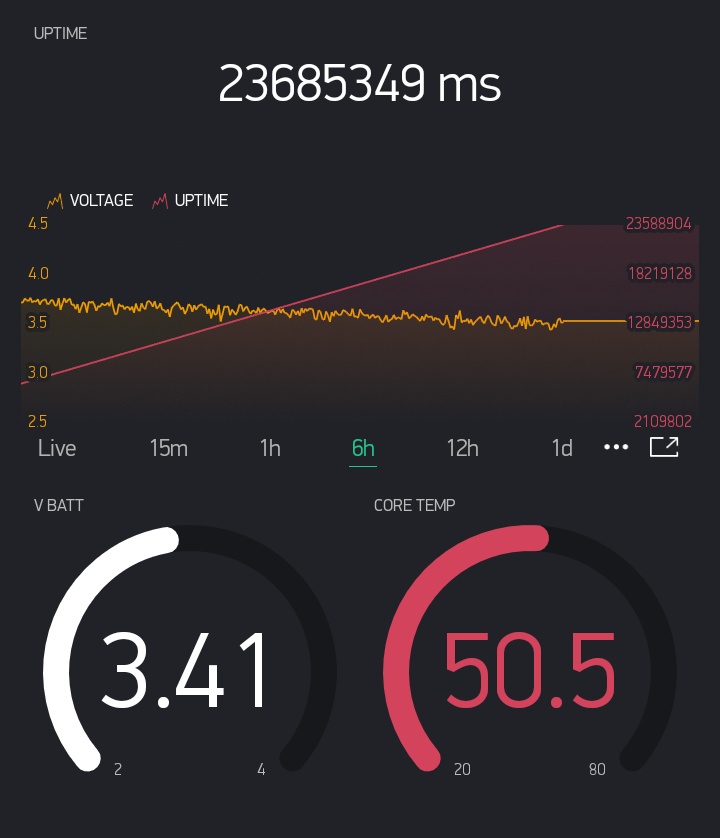

]]></description><link>https://community.m5stack.com/topic/3328/using-atom-lite-with-3-7v-on-5v-lane</link><generator>RSS for Node</generator><lastBuildDate>Mon, 11 May 2026 06:52:57 GMT</lastBuildDate><atom:link href="https://community.m5stack.com/topic/3328.rss" rel="self" type="application/rss+xml"/><pubDate>Fri, 28 May 2021 14:02:02 GMT</pubDate><ttl>60</ttl><item><title><![CDATA[Reply to Using atom lite with 3,7V on 5V lane on Fri, 25 Jun 2021 12:04:11 GMT]]></title><description><![CDATA[<p dir="auto">The problem is finding the atom lite schematic. It is not clear what voltage stabilizer was used. I suspect it has a voltage drop between input and output of ~1.0-1.2V. I connected a li-po cell (4.2V 900mAh) directly into the 5V input. I measured the cell voltage and sent the data to the local blynk server every 20 seconds. Additionally, I measured the internal temperature of the esp32 chip and it oscillated at a constant 50-51°C. With this connection the chip worked for about 6.5 hours and then turned off or stopped working properly at 3.41±0.1V cell voltage. So the esp32 chip probably stopped working at ~2.2-2.4V on a 3.3V supply line. I don't know how usb-uart converter will work with supply voltage lower than 5V. A colleague from "Esp Poland" forum tested power supply for ws2812 diode and at 3.9V the diode went crazy.<br />
Screenshot from blynk contain:</p>
<ul>
<li>cell coltage</li>
<li>esp32 internalge temperature</li>
<li>atom lite uptime/working time<br />
<img src="/assets/uploads/files/1624622423004-screenshot_20210523-193127-01.jpeg" alt="0_1624622420207_Screenshot_20210523-193127-01.jpeg" class=" img-fluid img-markdown" /></li>
