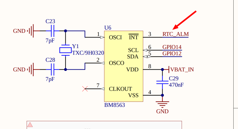

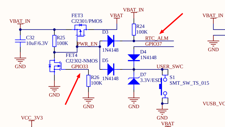

In fact, you can control the battery power supply through GPIO33, and rely on BM8563 RTC to wake up the device, which will save more battery life.<br />
<img src="/assets/uploads/files/1622512403453-2021-06-01_09-52-resized.png" alt="0_1622512402441_2021-06-01_09-52.png" class=" img-fluid img-markdown" /><br />
<img src="/assets/uploads/files/1622512446283-2021-06-01_09-53-resized.png" alt="0_1622512445689_2021-06-01_09-53.png" class=" img-fluid img-markdown" /></p>
