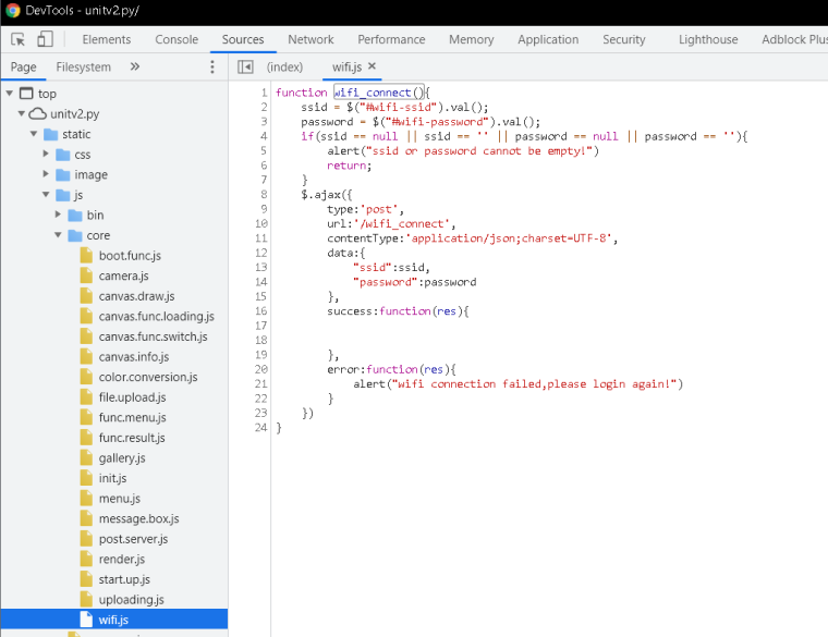

<img src="/assets/uploads/files/1624225422704-wifimodeapetc-resized.png" alt="0_1624225419502_wifimodeapetc.png" class=" img-fluid img-markdown" /></p>

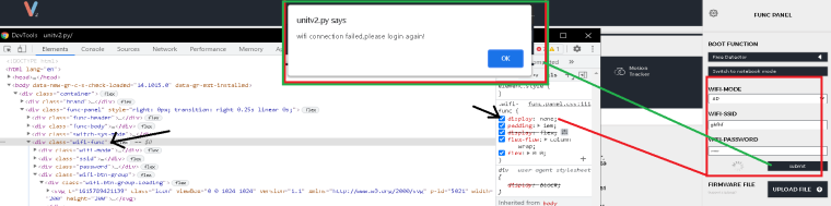

]]></description><link>https://community.m5stack.com/post/14157</link><guid isPermaLink="true">https://community.m5stack.com/post/14157</guid><dc:creator><![CDATA[Asmodev]]></dc:creator><pubDate>Sun, 20 Jun 2021 21:40:26 GMT</pubDate></item><item><title><![CDATA[Reply to Unit V2 Wi-Fi AP on Tue, 15 Jun 2021 19:32:02 GMT]]></title><description><![CDATA[<p dir="auto">Hello,</p>
