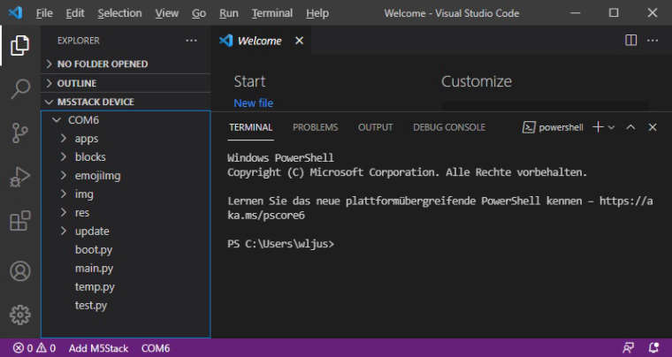

<img src="/assets/uploads/files/1623174429022-vscode_m5stack-resized.jpg" alt="0_1623174429537_vscode_m5stack.jpg" class=" img-fluid img-markdown" /></p>

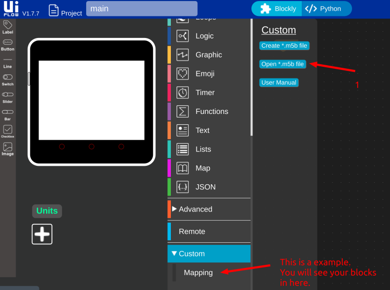

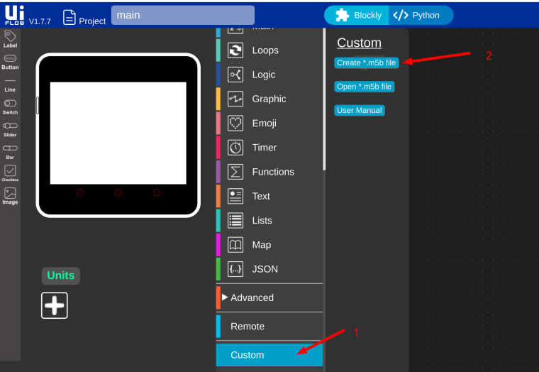

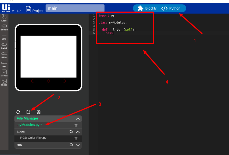

First you may need create your module file(like <a href="http://myModules.py" target="_blank" rel="noopener noreferrer nofollow ugc">myModules.py</a>) on UIFlow,and create some block for your modules.<br />
<img src="/assets/uploads/files/1622509887804-2021-06-01_09-09-resized.png" alt="0_1622509885440_2021-06-01_09-09.png" class=" img-fluid img-markdown" /></p>

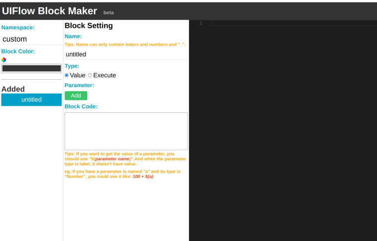

<p dir="auto">Then make some block for your modules.<br />
<img src="/assets/uploads/files/1622509957963-2021-06-01_09-12-resized.png" alt="0_1622509955738_2021-06-01_09-12.png" class=" img-fluid img-markdown" /></p>
<p dir="auto">Make some blocks on this workspace.<br />

]]></description><link>https://community.m5stack.com/post/13964</link><guid isPermaLink="true">https://community.m5stack.com/post/13964</guid><dc:creator><![CDATA[IAMLIUBO]]></dc:creator><pubDate>Tue, 01 Jun 2021 01:19:01 GMT</pubDate></item></channel></rss>
