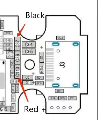

<?xml version="1.0" encoding="UTF-8"?><rss xmlns:dc="http://purl.org/dc/elements/1.1/" xmlns:content="http://purl.org/rss/1.0/modules/content/" xmlns:atom="http://www.w3.org/2005/Atom" version="2.0"><channel><title><![CDATA[Unit V2 fan pins]]></title><description><![CDATA[<p dir="auto">My unit V2 did ugly resonating noise so i opened cover and accidentally ripped the cables from the fan (why don't they have better connectors) can anybody send me detailed view where they are soldered (on picture on webpage its not clearly visible)</p>
<p dir="auto">thanks</p>
]]></description><link>https://community.m5stack.com/topic/3352/unit-v2-fan-pins</link><generator>RSS for Node</generator><lastBuildDate>Wed, 29 Apr 2026 00:09:10 GMT</lastBuildDate><atom:link href="https://community.m5stack.com/topic/3352.rss" rel="self" type="application/rss+xml"/><pubDate>Mon, 07 Jun 2021 20:39:03 GMT</pubDate><ttl>60</ttl><item><title><![CDATA[Reply to Unit V2 fan pins on Tue, 08 Jun 2021 07:45:38 GMT]]></title><description><![CDATA[<p dir="auto"><img src="/assets/uploads/files/1623138336519-ff611ecf-3820-4f6b-b9b6-b31583e9c0d4-1623138255.jpg" alt="0_1623138336130_ff611ecf-3820-4f6b-b9b6-b31583e9c0d4-1623138255.jpg" class=" img-fluid img-markdown" /></p>
