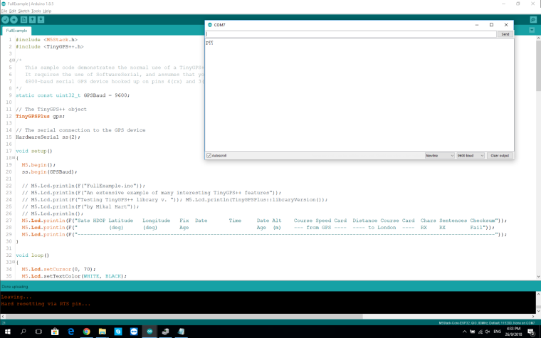

<?xml version="1.0" encoding="UTF-8"?><rss xmlns:dc="http://purl.org/dc/elements/1.1/" xmlns:content="http://purl.org/rss/1.0/modules/content/" xmlns:atom="http://www.w3.org/2005/Atom" version="2.0"><channel><title><![CDATA[Problem about M5stack GPS]]></title><description><![CDATA[<p dir="auto">I'm trying to use M5Stack GPS now and I have a problem.I tried the example from the arduino Examples/Modules/FullExample. I had tried a few days still cannot fix the problem.<br />
Here is the outcome of serial monitor.<img src="/assets/uploads/files/1538011467763-image-resized.png" alt="0_1538011463777_image.png" class=" img-fluid img-markdown" /><br />
And the outcome in the M5Stack is "No GPS data received: check wiring".Is that mean my GPS can't get data? How can I fix it?<br />
Thanks a lot!</p>

]]></description><link>https://community.m5stack.com/post/1610</link><guid isPermaLink="true">https://community.m5stack.com/post/1610</guid><dc:creator><![CDATA[ken57093]]></dc:creator><pubDate>Thu, 27 Sep 2018 04:15:50 GMT</pubDate></item><item><title><![CDATA[Reply to Problem about M5stack GPS on Thu, 27 Sep 2018 03:04:05 GMT]]></title><description><![CDATA[<p dir="auto"><a class="plugin-mentions-user plugin-mentions-a" href="/user/ken57093" aria-label="Profile: ken57093">@<bdi>ken57093</bdi></a> From your picture it looks like the baud rate maybe set wrong on your serial monitor. It should be 115200 baud</p>
]]></description><link>https://community.m5stack.com/post/1609</link><guid isPermaLink="true">https://community.m5stack.com/post/1609</guid><dc:creator><![CDATA[lukasmaximus]]></dc:creator><pubDate>Thu, 27 Sep 2018 03:04:05 GMT</pubDate></item></channel></rss>
