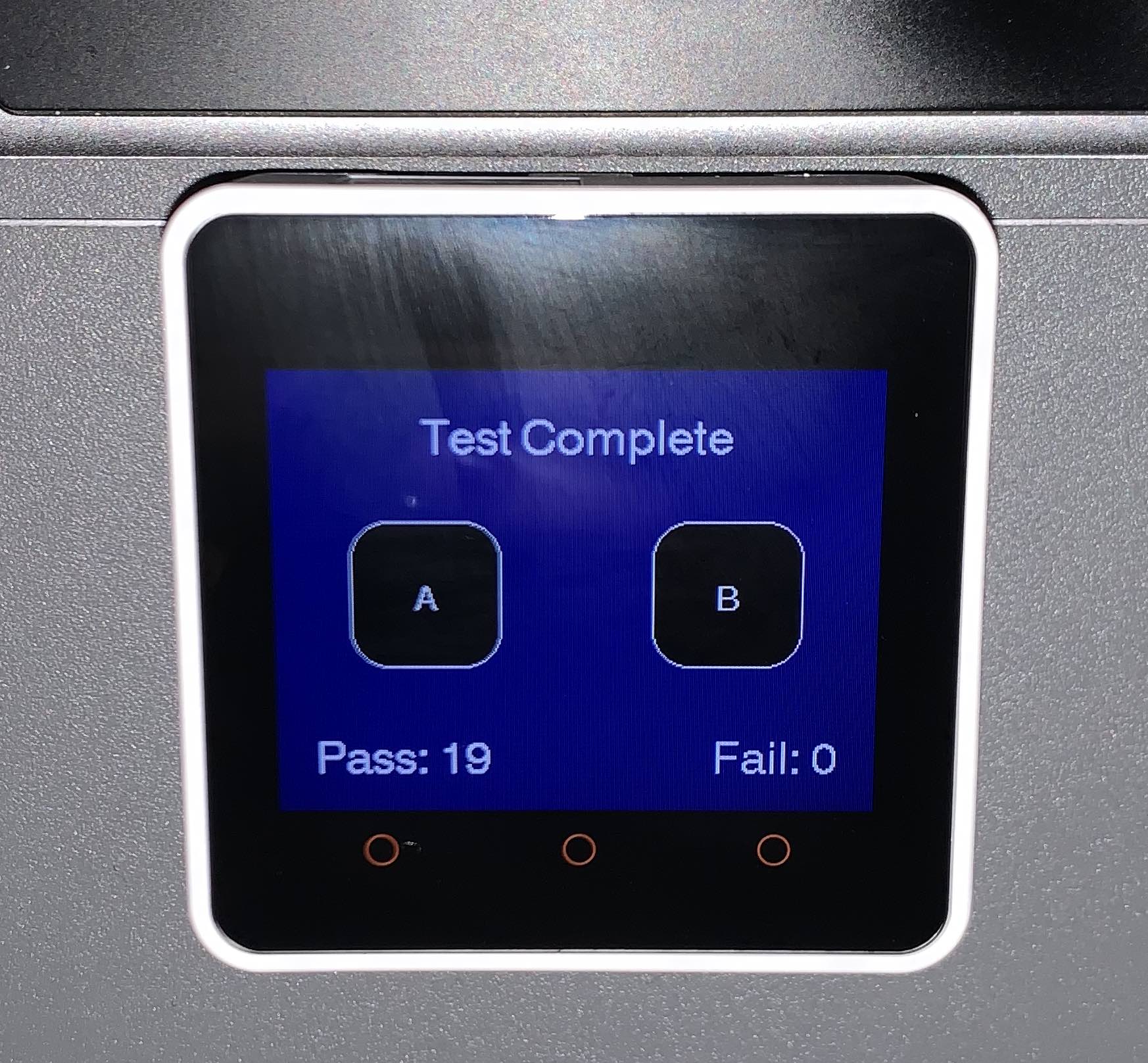

<?xml version="1.0" encoding="UTF-8"?><rss xmlns:dc="http://purl.org/dc/elements/1.1/" xmlns:content="http://purl.org/rss/1.0/modules/content/" xmlns:atom="http://www.w3.org/2005/Atom" version="2.0"><channel><title><![CDATA[UiFlow Touch unresponsive]]></title><description><![CDATA[<p dir="auto">Hello</p>
<p dir="auto">After installing the UIFLOW app v1.7.8-core2 on my device I noticed the touch buttons and screen do not respond to input. I read about the need to ground the device using either the USB or holding directly.  I have tried the older app version from v1.7.6-core2 and v1.7.6-core2.  I also tried my own touch app using the blockly editor and the demo Drawing board app. However, in both cases, the apps won't respond to input.</p>
<p dir="auto">At first, I thought the device was a dud and considering returning it. But when I flashed back to the Core2 FactoryTest application the screen does register inputs.</p>
<p dir="auto">I also compiled and installed the Arduino TouchGoal app and it works <img src="/assets/uploads/files/1624915355318-touchgoal-resized.jpg" alt="0_1624915352487_TouchGoal.jpg" class=" img-fluid img-markdown" /></p>
<p dir="auto">Is there a touch sensor issue in the current UiFlow firmware for the core2 series?</p>
