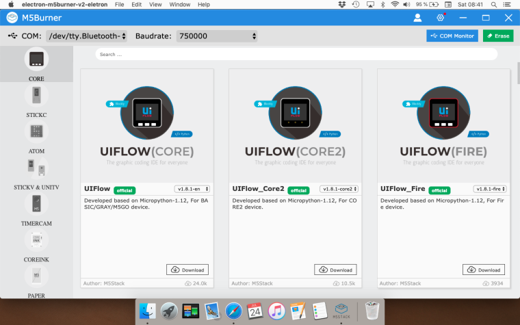

]]></description><link>https://community.m5stack.com/post/14501</link><guid isPermaLink="true">https://community.m5stack.com/post/14501</guid><dc:creator><![CDATA[ajb2k3]]></dc:creator><pubDate>Sun, 25 Jul 2021 07:00:33 GMT</pubDate></item><item><title><![CDATA[Reply to Core 2 looks dead, is it bricked? - fixed on Sat, 24 Jul 2021 11:01:45 GMT]]></title><description><![CDATA[<p dir="auto"><a class="plugin-mentions-user plugin-mentions-a" href="/user/ajb2k3" aria-label="Profile: ajb2k3">@<bdi>ajb2k3</bdi></a> It worked!! Thanks a lot! =)<br />
It took several tries to erase the M5, but suddenly it worked. I installed the factory test and it was also a success. I'm so happy!</p>
<p dir="auto">Can you give me any suggestion that this does not happen again? I use the serial terminal for debugging very often and it would be a little drawback developing without it.</p>
]]></description><link>https://community.m5stack.com/post/14495</link><guid isPermaLink="true">https://community.m5stack.com/post/14495</guid><dc:creator><![CDATA[urwaldfloh]]></dc:creator><pubDate>Sat, 24 Jul 2021 11:01:45 GMT</pubDate></item><item><title><![CDATA[Reply to Core 2 looks dead, is it bricked? - fixed on Sat, 24 Jul 2021 07:41:53 GMT]]></title><description><![CDATA[<p dir="auto"><a class="plugin-mentions-user plugin-mentions-a" href="/user/urwaldfloh" aria-label="Profile: urwaldfloh">@<bdi>urwaldfloh</bdi></a> yes it possible and that would explain why it cant update because the terminal is busy<br />
In M5 burner, did you try erasing the firmware before flashing? the erase button is sometimes hidden.!<img src="/assets/uploads/files/1627112509497-screenshot-2021-07-24-at-08.41.24-resized.png" alt="0_1627112506601_Screenshot 2021-07-24 at 08.41.24.png" class=" img-fluid img-markdown" /></p>
