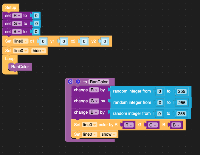

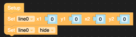

No, that just the way the blockly GUI options work in that you have to drag the UI element to the virtual screen to access the functions.<br />
Have you considered<br />
<img src="/assets/uploads/files/1627716157749-screenshot-2021-07-31-at-08.21.26.png" alt="0_1627716155995_Screenshot 2021-07-31 at 08.21.26.png" class=" img-fluid img-markdown" /></p>
<p dir="auto">Which then creates a hidden placeholder line which then give you access to the functions?<br />
and then you create a function to create a line with a random colour.<br />
<img src="/assets/uploads/files/1627716829375-screenshot-2021-07-31-at-08.33.25.png" alt="0_1627716826585_Screenshot 2021-07-31 at 08.33.25.png" class=" img-fluid img-markdown" /></p>
<p dir="auto">Edit Ahh I see, UI line and lcd line have different color functions</p>

<p dir="auto">It is possible to set variable for the individual colours on a numerical value.</p>
