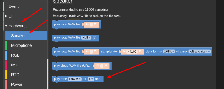

<?xml version="1.0" encoding="UTF-8"?><rss xmlns:dc="http://purl.org/dc/elements/1.1/" xmlns:content="http://purl.org/rss/1.0/modules/content/" xmlns:atom="http://www.w3.org/2005/Atom" version="2.0"><channel><title><![CDATA[M5core2 No Buzzer&#x2F;Beep options]]></title><description><![CDATA[<p dir="auto">Help<br />
Never had a problem with the core basic (flow/python/arduino)<br />
How do I program Buzzer/Beep sounds in core2.<br />
Cannot find the methods in the various libraries<br />
Thanks</p>
]]></description><link>https://community.m5stack.com/topic/3499/m5core2-no-buzzer-beep-options</link><generator>RSS for Node</generator><lastBuildDate>Fri, 01 May 2026 12:37:43 GMT</lastBuildDate><atom:link href="https://community.m5stack.com/topic/3499.rss" rel="self" type="application/rss+xml"/><pubDate>Wed, 04 Aug 2021 21:55:05 GMT</pubDate><ttl>60</ttl><item><title><![CDATA[Reply to M5core2 No Buzzer&#x2F;Beep options on Mon, 09 Aug 2021 02:56:23 GMT]]></title><description><![CDATA[<p dir="auto">Hi <a class="plugin-mentions-user plugin-mentions-a" href="/user/ganeyvim" aria-label="Profile: ganeyvim">@<bdi>ganeyvim</bdi></a> ,<br />
If you use UIFlow to do this, you can try this block:<br />
<img src="/assets/uploads/files/1628477476503-60f02e32-a5db-4554-b2a3-38f0936b42e6-image-resized.png" alt="0_1628477475551_60f02e32-a5db-4554-b2a3-38f0936b42e6-image.png" class=" img-fluid img-markdown" /></p>
<p dir="auto">And arduino code can refer here:<br />
<a href="https://github.com/m5stack/M5Core2/blob/master/examples/Basics/speak/speak.ino" target="_blank" rel="noopener noreferrer nofollow ugc">https://github.com/m5stack/M5Core2/blob/master/examples/Basics/speak/speak.ino</a></p>
