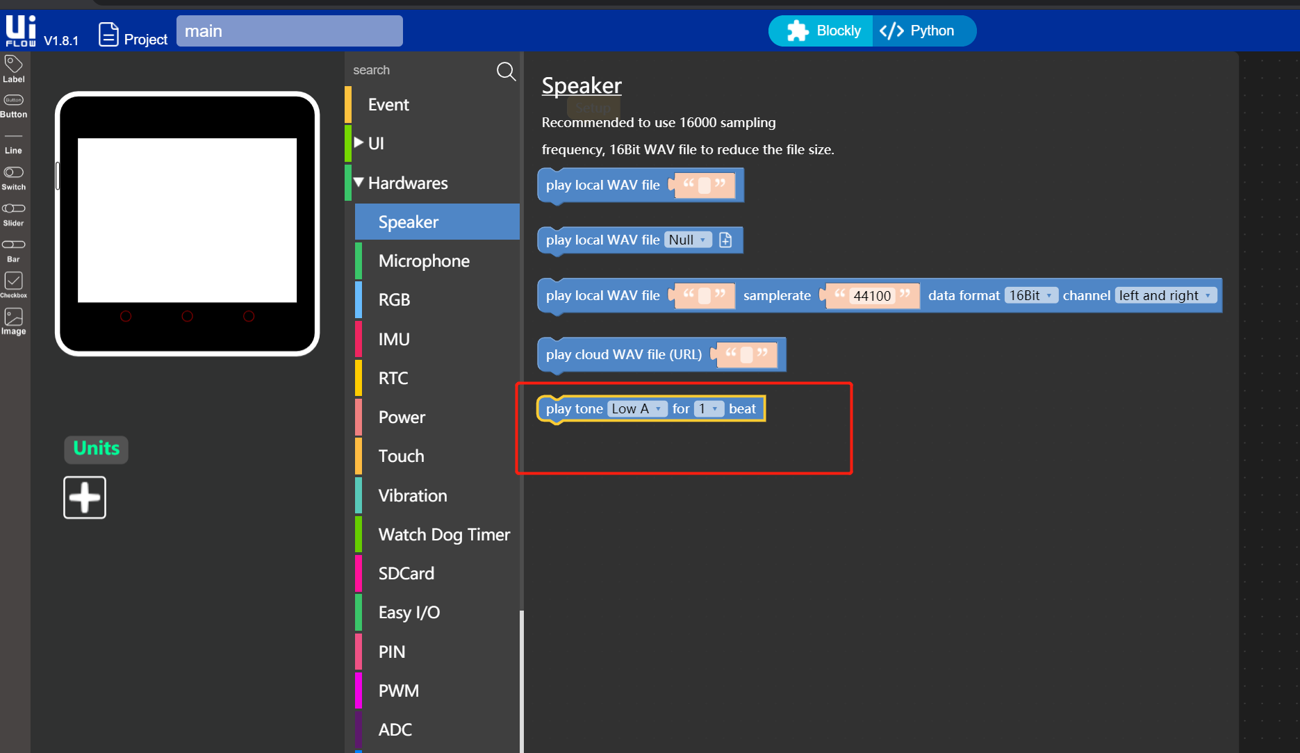

]]></description><link>https://community.m5stack.com/post/14584</link><guid isPermaLink="true">https://community.m5stack.com/post/14584</guid><dc:creator><![CDATA[ganeyvim]]></dc:creator><pubDate>Fri, 06 Aug 2021 18:52:47 GMT</pubDate></item><item><title><![CDATA[Reply to M5core2 No Buzzer&#x2F;Beep options on Fri, 06 Aug 2021 02:01:01 GMT]]></title><description><![CDATA[<p dir="auto">UIFlow already integrates this function.</p>
<p dir="auto"><img src="/assets/uploads/files/1628215223589-2a367e01-b874-43cc-a8f7-48d55413e1bb-image-resized.png" alt="0_1628215223979_2a367e01-b874-43cc-a8f7-48d55413e1bb-image.png" class=" img-fluid img-markdown" /></p>
