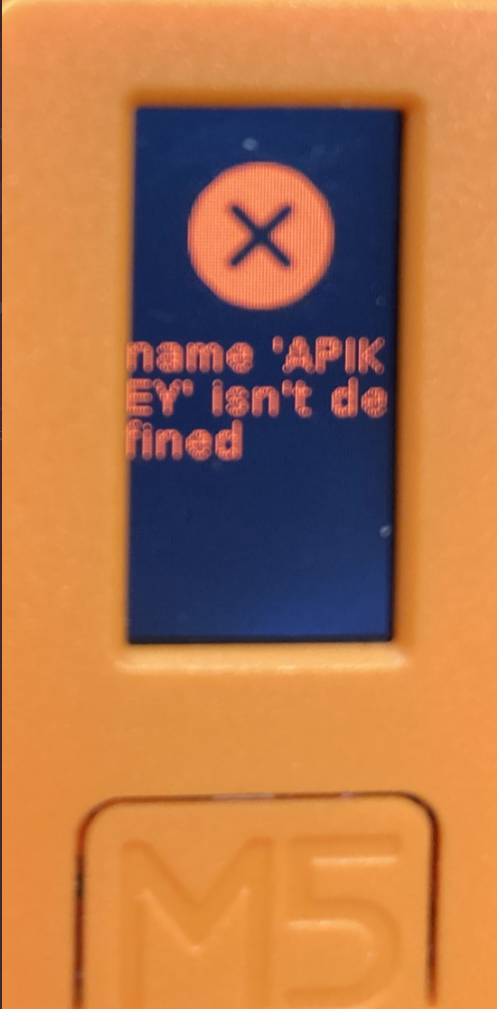

<p dir="auto">I tried the following code, but I get an error.</p>
from m5ui import *
from uiflow import *
setScreenColor(0x111111)
print(APIKEY)
</code></pre>
<p dir="auto"><img src="/assets/uploads/files/1630884810063-3f5e857e-8620-4937-b1db-9fd5be124cec-image.png" alt="0_1630884807759_3f5e857e-8620-4937-b1db-9fd5be124cec-image.png" class=" img-fluid img-markdown" /></p>
<p dir="auto">"_APIKEY" also resulted in an error.</p>
<p dir="auto">Do I need to install any additional modules?</p>

<pre><code>print(APIKEY)
#or
print(_APIKEY)
</code></pre>
<p dir="auto">Should work. On device boot in serial monitor was displayed all boot messages includes apikey.</p>
]]></description><link>https://community.m5stack.com/post/14805</link><guid isPermaLink="true">https://community.m5stack.com/post/14805</guid><dc:creator><![CDATA[robalstona]]></dc:creator><pubDate>Sun, 05 Sep 2021 08:16:55 GMT</pubDate></item></channel></rss>
