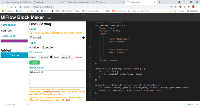

Thanks for confirming the syntax.<br />
I spotted that I had misread the custom block syntax rules and had included extra quotes.</p>
<p dir="auto">I now have a working custom block that simply removes the first and last characters.</p>
<p dir="auto">I have an input called Trimmer</p>
<p dir="auto">The code section has ${Trimmer}[1:-1]</p>
<p dir="auto"><img src="/assets/uploads/files/1631143767542-d8bb067c-1d3b-4c4c-8b83-272d56a88d4c-image-resized.png" alt="0_1631143765864_d8bb067c-1d3b-4c4c-8b83-272d56a88d4c-image.png" class=" img-fluid img-markdown" /></p>
]]></description><link>https://community.m5stack.com/post/14844</link><guid isPermaLink="true">https://community.m5stack.com/post/14844</guid><dc:creator><![CDATA[notdodgy]]></dc:creator><pubDate>Wed, 08 Sep 2021 23:30:29 GMT</pubDate></item><item><title><![CDATA[Reply to UIFlow - Trimming Strings on Tue, 07 Sep 2021 16:05:25 GMT]]></title><description><![CDATA[<p dir="auto"><a class="plugin-mentions-user plugin-mentions-a" href="/user/notdodgy" aria-label="Profile: notdodgy">@<bdi>notdodgy</bdi></a><br />

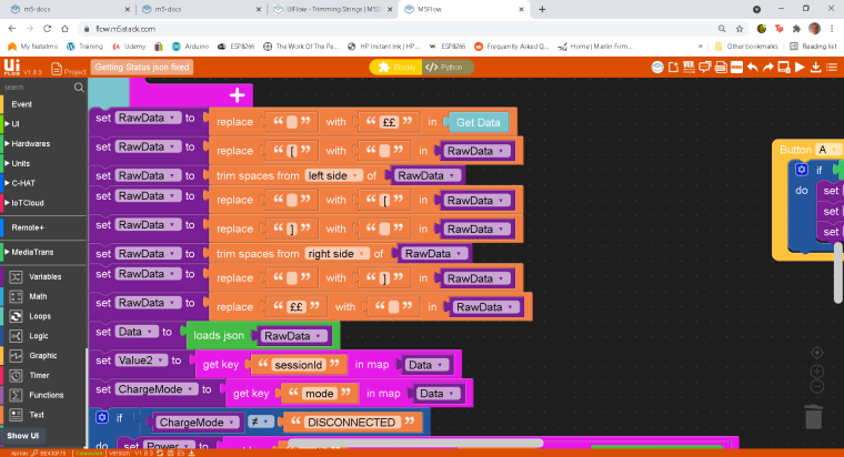

</blockquote>
<p dir="auto">That is what I used but to only remove the first and last characters takes a number of search and replaces.</p>
<p dir="auto"><img src="/assets/uploads/files/1630946118514-284d54f5-f2fb-46b4-a7ba-a192657c827f-image-resized.png" alt="0_1630946120197_284d54f5-f2fb-46b4-a7ba-a192657c827f-image.png" class=" img-fluid img-markdown" /></p>
