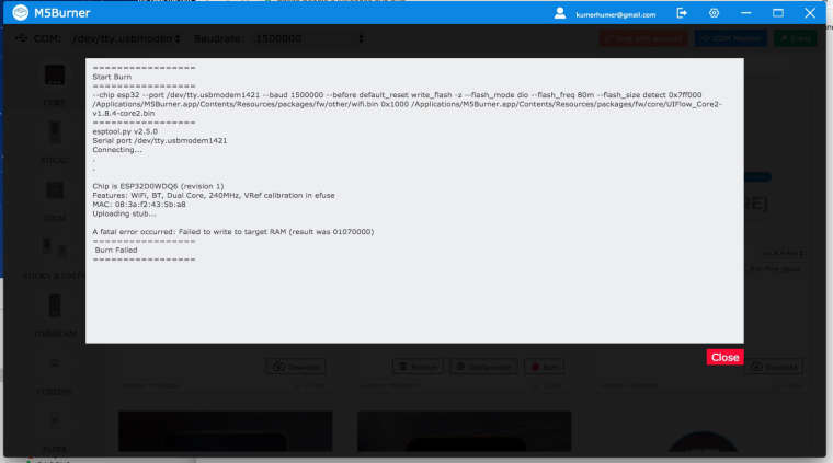

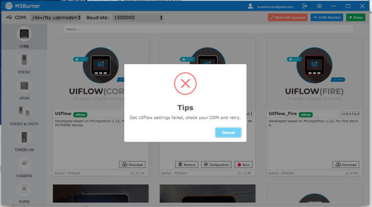

<?xml version="1.0" encoding="UTF-8"?><rss xmlns:dc="http://purl.org/dc/elements/1.1/" xmlns:content="http://purl.org/rss/1.0/modules/content/" xmlns:atom="http://www.w3.org/2005/Atom" version="2.0"><channel><title><![CDATA[problems to star my m5stack core 2]]></title><description><![CDATA[<p dir="auto">Hi everyone, I just received the m5stack core 2 and after downloading the drivers, burner, uflow and everything I've seen on the network, I can't connect the device with burnner and uflow, i try to check the COM and try again but I see that the bluetooth and usbmodem appear but not the COM. I'm new to all of this and I'm pretty lost. After searching a lot I have seen that there is a menu on the device where you can configure an activate the usb port by pressing the power button for 5 seconds but .... no matter how much I do, I am not able to access it. I imagine that once that port is activated, I will be able to connect the device to the m5burnner and to uflow. Thank you</p>

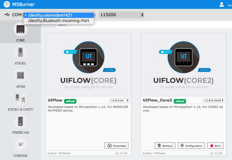

<img src="/assets/uploads/files/1632310641789-3-resized.jpg" alt="0_1632310632935_3.jpg" class=" img-fluid img-markdown" /></p>

It should appear as tty.SLAB_USBtoUART</p>
]]></description><link>https://community.m5stack.com/post/14923</link><guid isPermaLink="true">https://community.m5stack.com/post/14923</guid><dc:creator><![CDATA[ajb2k3]]></dc:creator><pubDate>Wed, 22 Sep 2021 05:21:57 GMT</pubDate></item><item><title><![CDATA[Reply to problems to star my m5stack core 2 on Tue, 21 Sep 2021 17:59:05 GMT]]></title><description><![CDATA[<p dir="auto"><a class="plugin-mentions-user plugin-mentions-a" href="/user/ajb2k3" aria-label="Profile: ajb2k3">@<bdi>ajb2k3</bdi></a> hello yes, I have restarted the computer and everything is the same. <img src="/assets/uploads/files/1632247062606-1-resized.jpg" alt="0_1632247057969_1.jpg" class=" img-fluid img-markdown" /><br />

]]></description><link>https://community.m5stack.com/post/14922</link><guid isPermaLink="true">https://community.m5stack.com/post/14922</guid><dc:creator><![CDATA[magnetor]]></dc:creator><pubDate>Tue, 21 Sep 2021 17:59:05 GMT</pubDate></item><item><title><![CDATA[Reply to problems to star my m5stack core 2 on Tue, 21 Sep 2021 15:57:20 GMT]]></title><description><![CDATA[<p dir="auto">have you shut your computer down and restarted it since installing drivers?</p>
