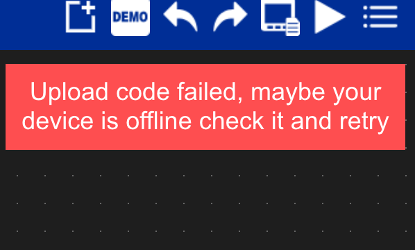

              • N Offline
                nigel @nigel
                This is the screenshot of the error from the IDE
                • ajb2k3A Offline
                  ajb2k3 @nigel
                  @nigel this message is a nightmare as it often means that there is a server issue but it could mean other things

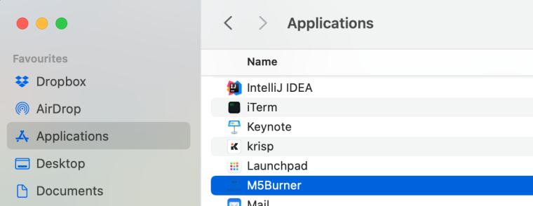

                          nigel @m5stack
                          @m5stack
                          I have followed the instructions. As I can see the driver is installed :
                          ❯ ls -ld /Library/Extensions/Si*
                          drwxr-xr-x 3 root wheel 96 3 Nov 2016 /Library/Extensions/SiLabsUSBDriver.kext
                          The application is in the applications folder as well :
