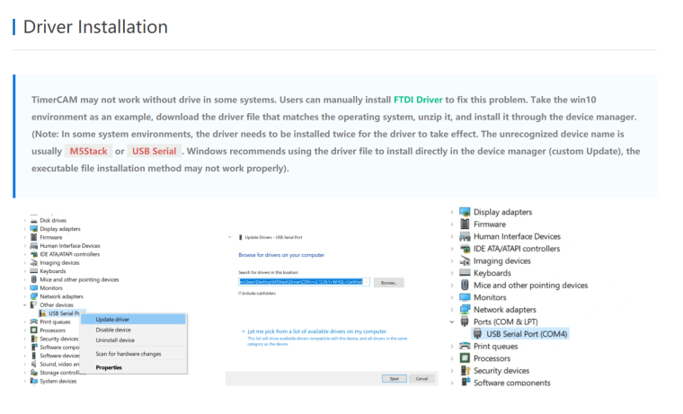

]]></description><link>https://community.m5stack.com/topic/3597/m5stick-c-and-timerx-camera-drivers-issues</link><generator>RSS for Node</generator><lastBuildDate>Fri, 15 May 2026 20:37:04 GMT</lastBuildDate><atom:link href="https://community.m5stack.com/topic/3597.rss" rel="self" type="application/rss+xml"/><pubDate>Fri, 24 Sep 2021 08:18:38 GMT</pubDate><ttl>60</ttl><item><title><![CDATA[Reply to M5stick C and TimerX camera drivers issues on Sun, 26 Sep 2021 02:18:03 GMT]]></title><description><![CDATA[<p dir="auto">Your PC can't identify the device COM?  or just can't upload the program? could you say more detail?</p>
<p dir="auto"><a href="https://docs.m5stack.com/en/unit/timercam_x" target="_blank" rel="noopener noreferrer nofollow ugc">https://docs.m5stack.com/en/unit/timercam_x</a></p>
<p dir="auto"><img src="/assets/uploads/files/1632622650371-ca7be514-895c-4f29-b4a5-948d9910c0cb-image-resized.png" alt="0_1632622648844_ca7be514-895c-4f29-b4a5-948d9910c0cb-image.png" class=" img-fluid img-markdown" /></p>
