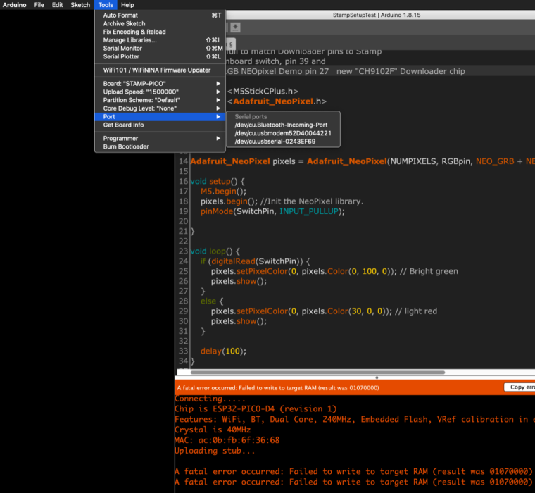

<?xml version="1.0" encoding="UTF-8"?><rss xmlns:dc="http://purl.org/dc/elements/1.1/" xmlns:content="http://purl.org/rss/1.0/modules/content/" xmlns:atom="http://www.w3.org/2005/Atom" version="2.0"><channel><title><![CDATA[New Downloader won&#x27;t connect on MACOS Catalina]]></title><description><![CDATA[<p dir="auto">Hi All.<br />
I am running latest Arduino IDE and Catalina. My first Downloader with CP2104 chip works fine with my Stamp-PICO.<br />
My new Downloader with CH9102F chip does not work with my Stamp-PICO.<br />
It appears in the Tools, Port as /dev/cu.usbmodem, but the usual usb appears as /dev/cu.usbserial.<br />
It runs ok on a old Win10 PC Laptop, but not on my main iMac.<br />
I get this error(s)<br />
A fatal error occurred: Failed to write to target RAM (result was 01070000)<br />
M5Stamp tech support sent me a CH34x driver but it would not install because of " OSSystemExtensionErrorDomain error 9 "<br />
While I can still program my stamps with the original Downloader, I would like to get the new one running on iMac!!!<br />
I am afraid that new M5Stack products, going forward will not run on iMac!<br />
Thanks in Advance.<br />
Terry<br />
<img src="/assets/uploads/files/1632540190979-unknown-resized.png" alt="0_1632540187711_unknown.png" class=" img-fluid img-markdown" /></p>

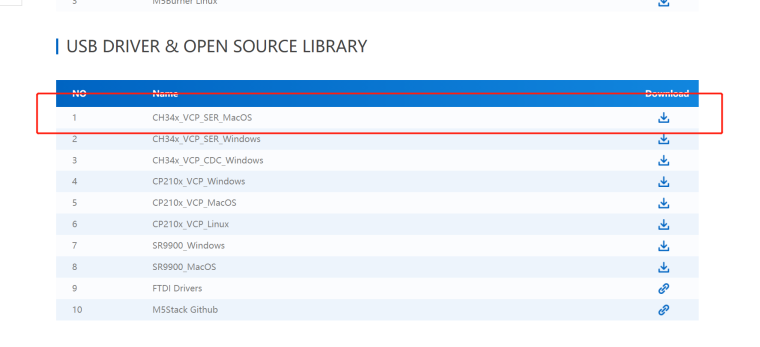

<p dir="auto"><a href="https://docs.m5stack.com/en/download" target="_blank" rel="noopener noreferrer nofollow ugc">https://docs.m5stack.com/en/download</a></p>
<p dir="auto"><img src="/assets/uploads/files/1632621695079-d5d0424a-e5ad-4a3d-b778-eaeb63c57fd2-image-resized.png" alt="0_1632621694333_d5d0424a-e5ad-4a3d-b778-eaeb63c57fd2-image.png" class=" img-fluid img-markdown" /></p>
