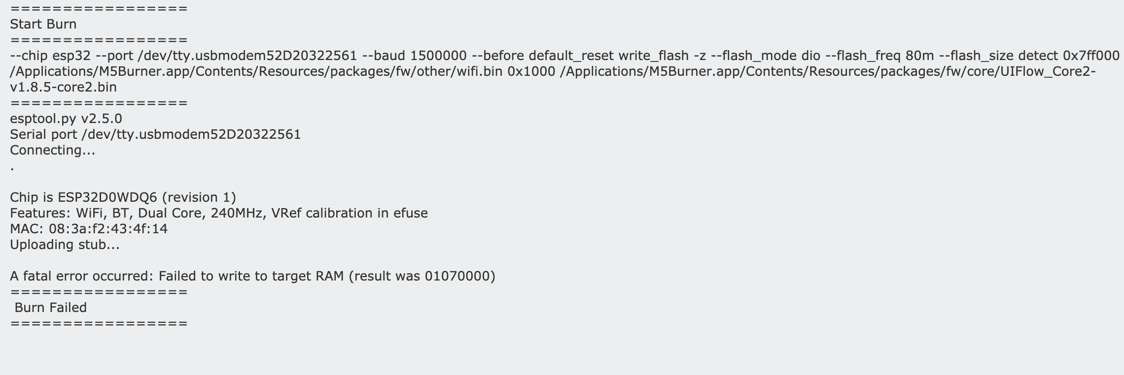

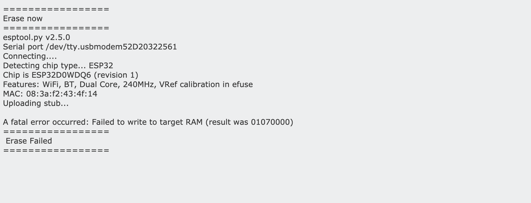

<?xml version="1.0" encoding="UTF-8"?><rss xmlns:dc="http://purl.org/dc/elements/1.1/" xmlns:content="http://purl.org/rss/1.0/modules/content/" xmlns:atom="http://www.w3.org/2005/Atom" version="2.0"><channel><title><![CDATA[New Core 2 Issues]]></title><description><![CDATA[<p dir="auto">Hi all:<br />
My new arrival Core 2 can not be erased or burn the new firmware:</p>
<p dir="auto"><img src="/assets/uploads/files/1634223196852-7d34e1d2-52f1-4e52-b2af-5c0f6ed13928-image-resized.png" alt="0_1634223195032_7d34e1d2-52f1-4e52-b2af-5c0f6ed13928-image.png" class=" img-fluid img-markdown" /><br />
and :<br />
<img src="/assets/uploads/files/1634223266416-98a35f14-68a3-48a8-a8a1-3f04df0b9008-image-resized.png" alt="0_1634223264655_98a35f14-68a3-48a8-a8a1-3f04df0b9008-image.png" class=" img-fluid img-markdown" /></p>
<p dir="auto">what am I wrong here? I just follow the instructions in the docs.</p>

<p dir="auto">Hi, sorry for your problems with burning...frustrating to say the least!</p>
<p dir="auto">I would attempt to try repeating the process from another computer...is that an option?</p>
<p dir="auto">Let's try to figure out if this is a communication error or a Core 2 defect?</p>
<p dir="auto">Keep us updated!</p>
