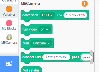

<ul>
<li>cannot stream video.</li>
<li>transferring image is very slow (8~20sec)</li>
</ul>
<p dir="auto">[procedure]</p>
<ol>
<li>
<p dir="auto">burn firmware (customized CameraWebServer)<br />
<a href="https://sohta02.sakura.ne.jp/tukurutch/" target="_blank" rel="noopener noreferrer nofollow ugc">https://sohta02.sakura.ne.jp/tukurutch/</a><br />
[Add extension]<br />
-- [M5Camera,ESP32cam,..]<br />
-- pulldown [burn (M5Camera)] to UnitCam<br />
-- click [burn (UnitCam)]</p>
</li>
<li>
<p dir="auto">enter SSID and pass to [connect ssid ..] and click it.</p>
</li>
<li>
<p dir="auto">click [Wifi Status] and get IP address<br />

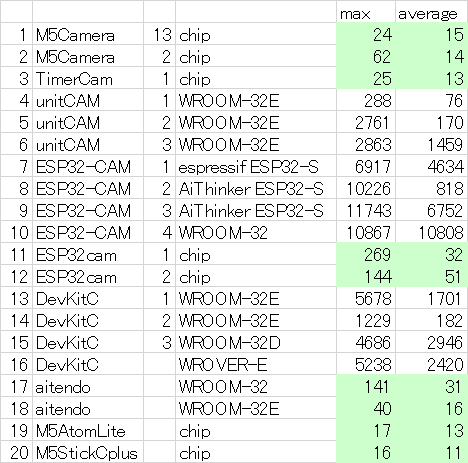

<ul>
<li>chip-ESP32 is better than WROOM-32x.</li>
<li>"aitendo" PCB is good.</li>
</ul>
<p dir="auto">The "reworked" unitCam is No.4, the result was not bad, but not enough.</p>
]]></description><link>https://community.m5stack.com/post/15246</link><guid isPermaLink="true">https://community.m5stack.com/post/15246</guid><dc:creator><![CDATA[sohtamei]]></dc:creator><pubDate>Tue, 26 Oct 2021 05:00:53 GMT</pubDate></item><item><title><![CDATA[Reply to [UNITCAM][HW issue?] cannot stream video. on Tue, 26 Oct 2021 09:13:08 GMT]]></title><description><![CDATA[<p dir="auto">I found the route cause of this issue - XCLK=20MHz of ESP32 makes WIFI-through-rate slow. This issue can be reproduced without ov2640. I prepared dummy network camera firmware, which can run dummy streaming, and can turn on/off XCLK with "AWB" slide bar. Please see following video:<br />

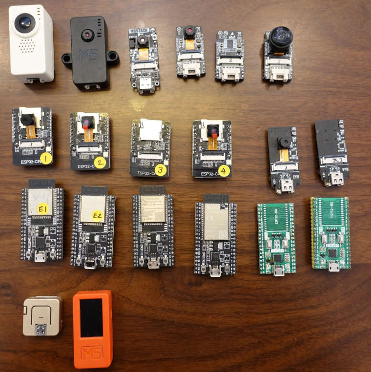

<a href="http://sohta02.web.fc2.com/images/esp32CameraWebServerIssue.mp4" target="_blank" rel="noopener noreferrer nofollow ugc">http://sohta02.web.fc2.com/images/esp32CameraWebServerIssue.mp4</a></p>
<p dir="auto">I tried following ESP32 devices:<br />
<img src="/assets/uploads/files/1635223865165-dsc05557-resized.jpg" alt="0_1635223861922_DSC05557.JPG" class=" img-fluid img-markdown" /></p>
<p dir="auto">The result was following:</p>
<ul>
<li>Max duration and average of "Get Still" for 20~30 cycles [ms]<br />
<img src="/assets/uploads/files/1635223927707-7072086f-e1a9-4011-bd0e-5dc8fdd01043-image.png" alt="0_1635223924489_7072086f-e1a9-4011-bd0e-5dc8fdd01043-image.png" class=" img-fluid img-markdown" /></li>
</ul>
]]></description><link>https://community.m5stack.com/post/15245</link><guid isPermaLink="true">https://community.m5stack.com/post/15245</guid><dc:creator><![CDATA[sohtamei]]></dc:creator><pubDate>Tue, 26 Oct 2021 09:13:08 GMT</pubDate></item><item><title><![CDATA[Reply to [UNITCAM][HW issue?] cannot stream video. on Wed, 03 Nov 2021 19:46:16 GMT]]></title><description><![CDATA[<p dir="auto">I found better solution.<br />

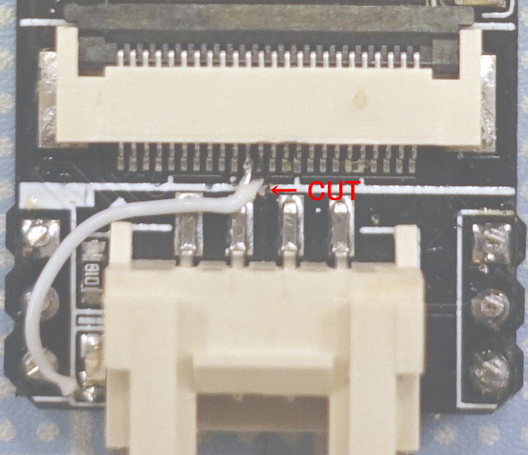

<s>I tried PCB-rework - cut between DOVDD and 2.8V, then connect DOVDD to 3V.<br />
The transfer rate of Image has been improved, and I succeeded in streaming Video.<br />
JPG: 17013B 407ms<br />
JPG: 17258B 331ms<br />
JPG: 17133B 170ms<br />
JPG: 17062B 154ms<br />
JPG: 17090B 164ms</s></p>
<p dir="auto"><img src="/assets/uploads/files/1634387187622-dsc05548.jpg" alt="0_1634387186741_DSC05548.JPG" class=" img-fluid img-markdown" /></p>

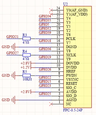

with ESP32-CAM, which has similar schematics with UnitCam, I can stream video with CameraWebServer.<br />
The differences between UnitCam and ESP32-CAM are port assignment and camera powers.</p>
<ul>
<li>DOVDD and AVDD are not separated.</li>
</ul>
<p dir="auto">I cannot try PCB-rework for UnitCam, so I'm not sure whether separation of DOVDD-AVDD is root cause. But there may be some HW issue on UnitCam PCB.</p>
<p dir="auto"><img src="/assets/uploads/files/1634370933389-ac92bf82-d067-4778-aac9-631cbdd146f0-image.png" alt="0_1634370931477_ac92bf82-d067-4778-aac9-631cbdd146f0-image.png" class=" img-fluid img-markdown" /></p>
