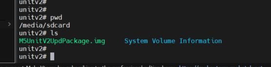

<?xml version="1.0" encoding="UTF-8"?><rss xmlns:dc="http://purl.org/dc/elements/1.1/" xmlns:content="http://purl.org/rss/1.0/modules/content/" xmlns:atom="http://www.w3.org/2005/Atom" version="2.0"><channel><title><![CDATA[UnitV2 - save to SD card?]]></title><description><![CDATA[<p dir="auto">Hello, I just started playing with a UnitV2 camera from work.  I was wondering if there was a way to have the camera start recording a 30 second clip when it detects something in it's FOV?  I can interface with this using the <a href="http://unitv2.py" target="_blank" rel="noopener noreferrer nofollow ugc">unitv2.py</a> code, but can't find an example on how to record to an SD card.  If anyone can get me started in the right direction, it would be much appreciated</p>

]]></description><link>https://community.m5stack.com/post/15344</link><guid isPermaLink="true">https://community.m5stack.com/post/15344</guid><dc:creator><![CDATA[awanamak]]></dc:creator><pubDate>Tue, 02 Nov 2021 22:02:03 GMT</pubDate></item><item><title><![CDATA[Reply to UnitV2 - save to SD card? on Thu, 28 Oct 2021 11:22:22 GMT]]></title><description><![CDATA[<p dir="auto"><img src="/assets/uploads/files/1635420125478-97f2d44a-fa31-4d5f-8d13-beb528f5fb38-image.png" alt="0_1635420125709_97f2d44a-fa31-4d5f-8d13-beb528f5fb38-image.png" class=" img-fluid img-markdown" /></p>
<p dir="auto">just save the file to this path</p>
