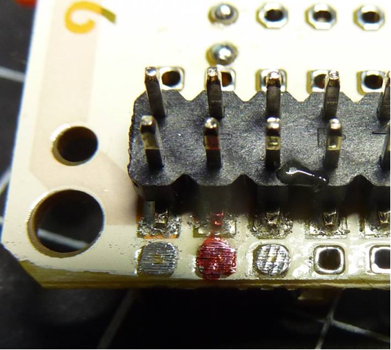

I notified M5Stack support to warn of the incompatibility</p>
