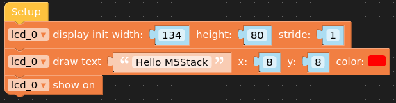

<p dir="auto">using UIFlow 1.9.0 works for me (well kind of). With M5Core2 I can use the whole LCD unit screen (eg. 135 x 240). However with M5Atom (or M5StickCPlus) I can only use part of it, else there is an out of memory error. Here is what works for me with M5Atom.</p>
<p dir="auto"><img src="/assets/uploads/files/1642182496709-m5atomlcdunituiflow_220114.png" alt="0_1642182495468_M5AtomLCDUnitUIFlow_220114.png" class=" img-fluid img-markdown" /><br />
Thanks<br />
Felix</p>
<p dir="auto">Thanx Felix, it's indeed now working for a small partion of the screen when connected to my M5StickC Plus. Trying to set it to it's actual size indeed results in a memory allocation error. I had seen that one before as well but didnt think it was related to the screen size. If anyone knows how to fix the memory allocation error, please let me know.</p>
Thanks<br />
Felix</p>
