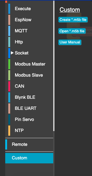

Once you have a code that returns the data that you need, you need to convert it to a library or driver, download the driver to the esp32 and then create  custom blocks in the custom block creator<img src="/assets/uploads/files/1636528678054-screenshot-2021-11-10-at-07.17.15.png" alt="0_1636528676537_Screenshot 2021-11-10 at 07.17.15.png" class=" img-fluid img-markdown" /><br />
<img src="/assets/uploads/files/1636528690053-screenshot-2021-11-10-at-07.17.46-resized.png" alt="0_1636528687784_Screenshot 2021-11-10 at 07.17.46.png" class=" img-fluid img-markdown" /><br />
That will allow you new driver/library to work in uiflow.</p>
