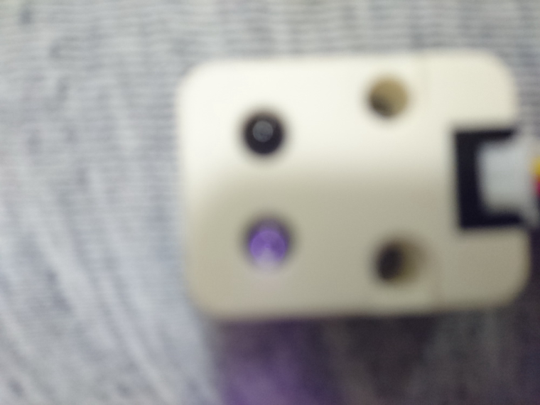

]]></description><link>https://community.m5stack.com/post/1776</link><guid isPermaLink="true">https://community.m5stack.com/post/1776</guid><dc:creator><![CDATA[ajb2k3]]></dc:creator><pubDate>Sat, 20 Oct 2018 10:54:29 GMT</pubDate></item><item><title><![CDATA[Reply to UI Flow Software 0.8.0 Sensor problems on Sat, 20 Oct 2018 09:11:18 GMT]]></title><description><![CDATA[<p dir="auto">Nothing to thank @ ajb2k3,</p>
<p dir="auto">I first installed UIFlow 0.8.0 on the M5Stack. Then tested, then a lot on me the sensor does not send over the camera of the mobile phone.<br />
Afterwards I installed UIFlow 0.7.0 on the M5Stack and lo and behold, the sensor is sending !! You can see it in both pictures !!<br />
Greeting skink</p>
]]></description><link>https://community.m5stack.com/post/1775</link><guid isPermaLink="true">https://community.m5stack.com/post/1775</guid><dc:creator><![CDATA[Skink]]></dc:creator><pubDate>Sat, 20 Oct 2018 09:11:18 GMT</pubDate></item><item><title><![CDATA[Reply to UI Flow Software 0.8.0 Sensor problems on Sat, 20 Oct 2018 08:05:31 GMT]]></title><description><![CDATA[<p dir="auto"><a class="plugin-mentions-user plugin-mentions-a" href="/user/skink" aria-label="Profile: skink">@<bdi>skink</bdi></a> Thanks, been struggling to find those docs.</p>

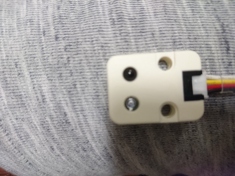

Out of curiosity (I dont have any of the sensors) any chance you can open the case and capture a photo of the internals?<br />
BTW pull the camera back about a foot and retake the photos!</p>

]]></description><link>https://community.m5stack.com/post/1770</link><guid isPermaLink="true">https://community.m5stack.com/post/1770</guid><dc:creator><![CDATA[ajb2k3]]></dc:creator><pubDate>Sat, 20 Oct 2018 07:43:20 GMT</pubDate></item><item><title><![CDATA[Reply to UI Flow Software 0.8.0 Sensor problems on Fri, 19 Oct 2018 22:40:02 GMT]]></title><description><![CDATA[<p dir="auto">Here are the pictures ,<br />
Software 0.8.0 IR Remote Transmitter diode sending nothing !!<br />
<img src="/assets/uploads/files/1539988780409-dsc_0781-resized.jpg" alt="0_1539988778458_DSC_0781.JPG" class=" img-fluid img-markdown" /></p>
<p dir="auto">Here Software 0.7.0 IR Remote Transmitter Diode Sends Signal !!<br />
<img src="/assets/uploads/files/1539988793489-dsc_0782-resized.jpg" alt="0_1539988792635_DSC_0782.JPG" class=" img-fluid img-markdown" /><br />
Greetings Skink</p>

Have again the software UI Flow 0.8.0 installed. And again tested the sensors. Only the IO Remote Sensor is not working in the software.<br />
Have this as well as the other sensors connected to the Black Port (B / GPIO).<br />
It is only the ENV sensor connected to the port (A / I2C), that's already clear to me.<br />
But you can also see a cell phone camera when you connect the IO Remote Sensor to the port (B / GPIO) port in the software 0.8.0 of the infrared sensor emits no infrared light, but in the software 0.7.0! !<br />
Look at the pictures !!!!<br />
Greeting skink</p>
