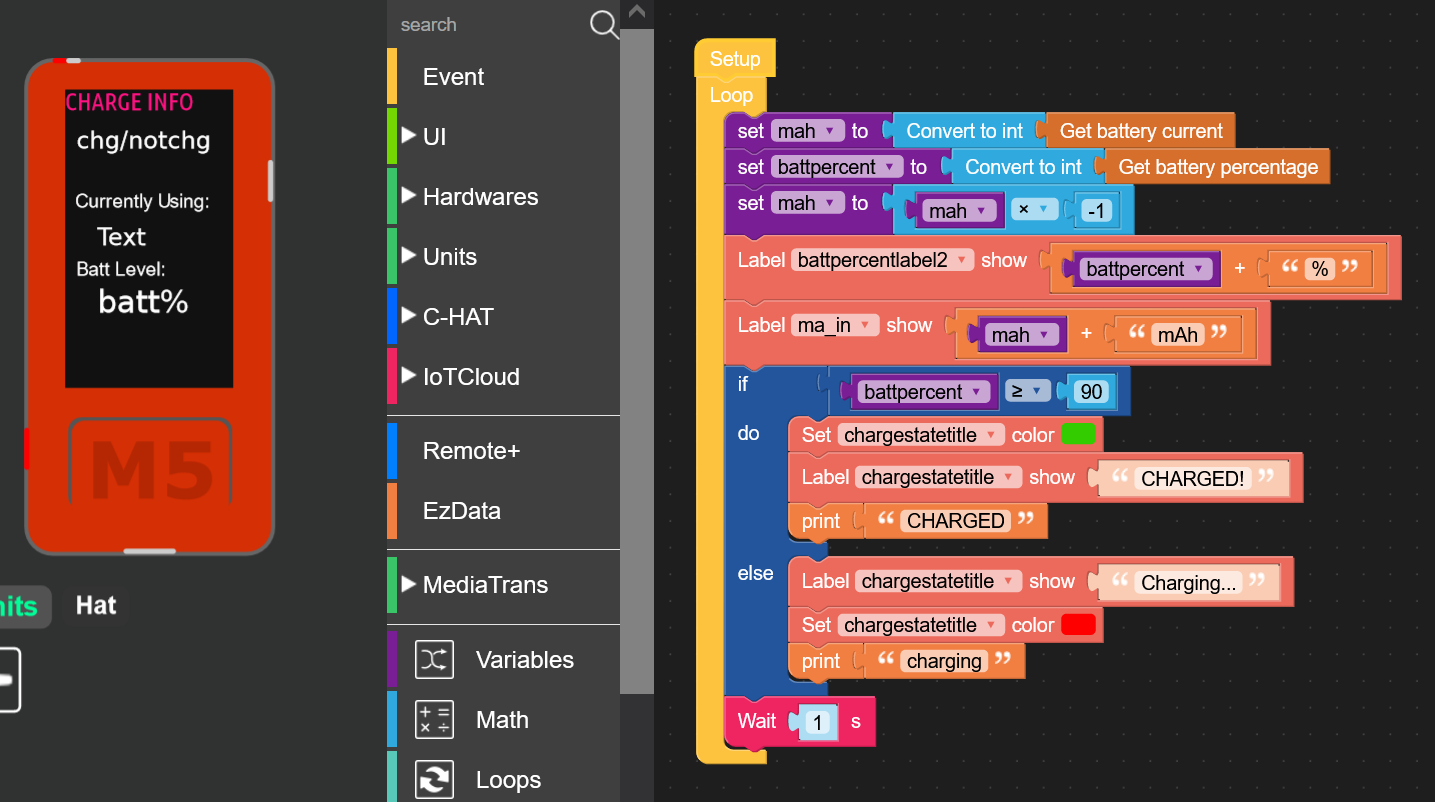

<?xml version="1.0" encoding="UTF-8"?><rss xmlns:dc="http://purl.org/dc/elements/1.1/" xmlns:content="http://purl.org/rss/1.0/modules/content/" xmlns:atom="http://www.w3.org/2005/Atom" version="2.0"><channel><title><![CDATA[Rover and Joystick Battery Charging Status Screen]]></title><description><![CDATA[<p dir="auto">I wrote a small program in UIFlow for my M5StickC Plus named chargeinfo.m5f to monitor the battery charging for my roverc and joystick.  Hopefully someone else will find it useful.</p>
<p dir="auto"><a href="https://github.com/adammelancon/M5Stack" target="_blank" rel="noopener noreferrer nofollow ugc">https://github.com/adammelancon/M5Stack</a></p>
<p dir="auto"><img src="/assets/uploads/files/1636927240382-e6e00864-2dd5-4780-adc0-d8017374c66b-image-resized.png" alt="0_1636927239621_e6e00864-2dd5-4780-adc0-d8017374c66b-image.png" class=" img-fluid img-markdown" /></p>
