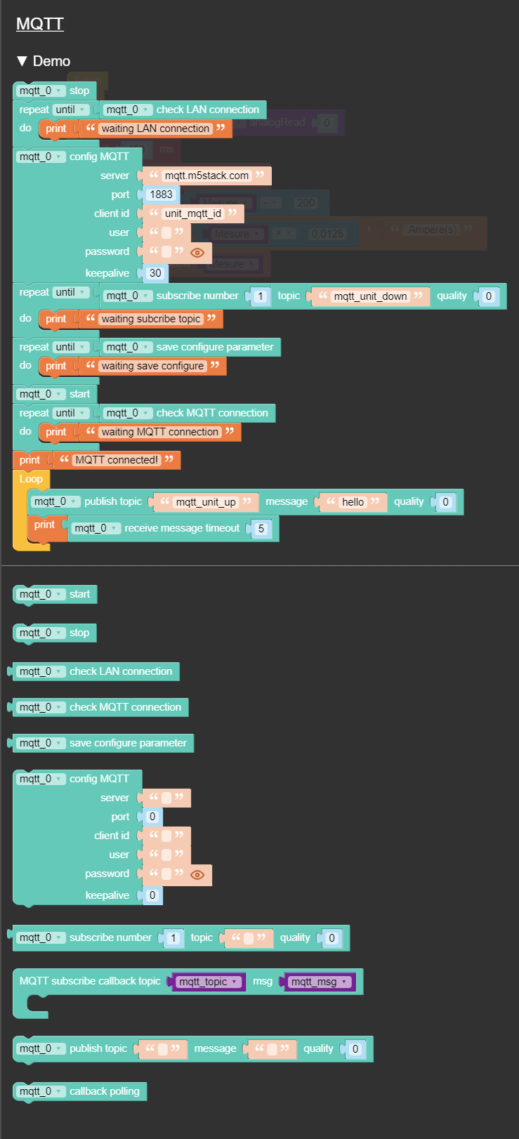

<p dir="auto">I just received the new MQTT unit.<br />
I was using MQTT in WIFI with my M5s like this with UIFlow:<br />
<img src="/assets/uploads/files/1637010663614-666e51af-52f2-4ae1-9367-37d6844298d8-image.png" alt="0_1637010663460_666e51af-52f2-4ae1-9367-37d6844298d8-image.png" class=" img-fluid img-markdown" /><br />
avec les fonctions suivantes :<br />
<img src="/assets/uploads/files/1637010712946-1ce5ee80-a0d6-4be4-99ef-2bca4a429034-image.png" alt="0_1637010712632_1ce5ee80-a0d6-4be4-99ef-2bca4a429034-image.png" class=" img-fluid img-markdown" /></p>

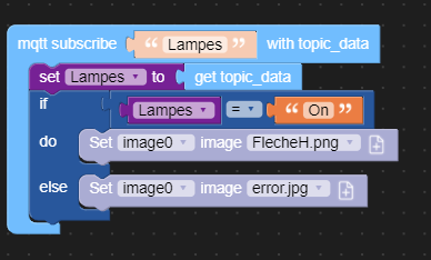

<p dir="auto">With the new unit I am a little confused to do the same. I do not find the same functions to carry out "MQTT subscribe"<br />
<img src="/assets/uploads/files/1637010601997-a597c6d0-7d66-4097-b122-25250570ecb6-image.png" alt="0_1637010600771_a597c6d0-7d66-4097-b122-25250570ecb6-image.png" class=" img-fluid img-markdown" /><br />
How to achieve the same?</p>
<p dir="auto">Thanks for your help</p>

]]></description><link>https://community.m5stack.com/post/16046</link><guid isPermaLink="true">https://community.m5stack.com/post/16046</guid><dc:creator><![CDATA[felmue]]></dc:creator><pubDate>Tue, 04 Jan 2022 08:44:49 GMT</pubDate></item><item><title><![CDATA[Reply to use new MQTT unit with UIFlow? on Sun, 02 Jan 2022 21:22:32 GMT]]></title><description><![CDATA[<p dir="auto">With the new version UIFLOW 1.9.0 I finally have used my MQTT UNIT. But the limit of 4 subscribe strongly limits my project ... I hope this limit will be delete during a future version.</p>

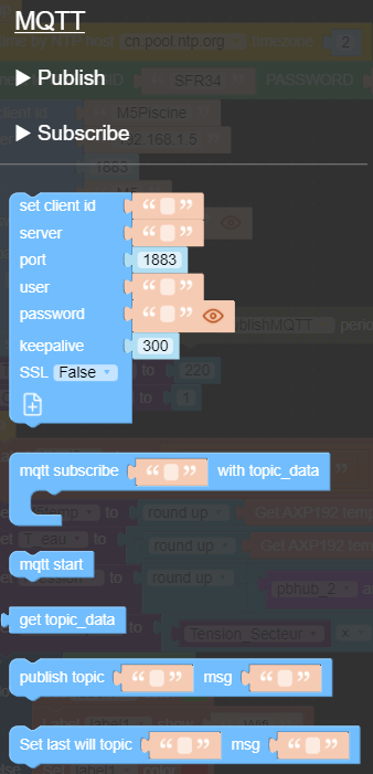

As indicated in my previous email, my one and only problem is to recover my data (Subscribe) since there is no GET DATA function in UIflow with the MQTT Unit.</p>
<p dir="auto">In MQTT wifi there is this:</p>
<p dir="auto"><img src="/assets/uploads/files/1639761555868-2c013dca-ee02-48c2-8ea8-4d5e26baf148-image.png" alt="0_1639761555424_2c013dca-ee02-48c2-8ea8-4d5e26baf148-image.png" class=" img-fluid img-markdown" /></p>
<p dir="auto">How do you proceed with MQTT unit to achieve the same thing ????</p>
<p dir="auto">There is no example in Uiflow on the use of the MQTT unit!</p>

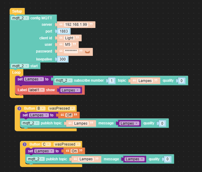

Sorry, but I still cannot recover my data from the broker with the MQTT unit. It works perfect with MQTT in Wifi and my CORE2.<br />
Here is my code with UIFlow, the LAMPES variable is always at TRUE, as the BOOKER MQTT communicates values "On" or "Off"<br />
How to get the GET TOPIC DATA function?</p>
<p dir="auto"><img src="/assets/uploads/files/1637418577789-4289a9a4-29aa-4974-a34c-eb270c0b6bac-image.png" alt="0_1637418577227_4289a9a4-29aa-4974-a34c-eb270c0b6bac-image.png" class=" img-fluid img-markdown" /></p>

<p dir="auto">you could take a variable to connect the block. after the block is executed, it will return a result of subscribing successfully.</p>
]]></description><link>https://community.m5stack.com/post/15516</link><guid isPermaLink="true">https://community.m5stack.com/post/15516</guid><dc:creator><![CDATA[m5stack]]></dc:creator><pubDate>Fri, 19 Nov 2021 04:35:00 GMT</pubDate></item></channel></rss>
