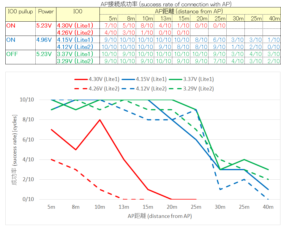

<p dir="auto">This issue has been fixed with "IO0-pullup-OFF" firmware for CH552 (GREEN LINE).<br />
<img src="/assets/uploads/files/1637628696922-77a33f0a-4480-4037-a093-4556f199b4ec-image-resized.png" alt="0_1637628695510_77a33f0a-4480-4037-a093-4556f199b4ec-image.png" class=" img-fluid img-markdown" /></p>
<p dir="auto"><a href="https://sohtamei.github.io/docs/esp32AndUsbUartWith5V_IO_Issue.html" target="_blank" rel="noopener noreferrer nofollow ugc">https://sohtamei.github.io/docs/esp32AndUsbUartWith5V_IO_Issue.html</a><br />
<a href="https://sohtamei.github.io/docs/esp32AndUsbUartWith5V_IO_Issue2.html" target="_blank" rel="noopener noreferrer nofollow ugc">https://sohtamei.github.io/docs/esp32AndUsbUartWith5V_IO_Issue2.html</a><br />
Please translate language on Browser.</p>
