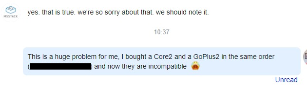

<p dir="auto">I found problems, then contacted directly M5 and they explained that Core2 and GoPlus2 are not compatible in a direct message.</p>
<p dir="auto">Hope this thread helps next people.</p>

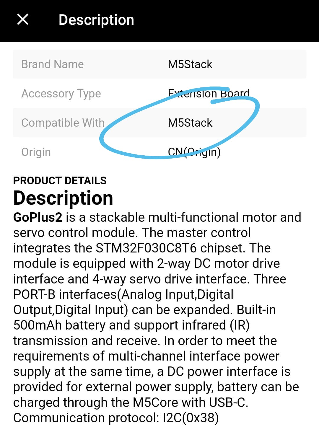

<p dir="auto">ok, thank you for letting us know.</p>
<p dir="auto">Where exactly did you find the GoPlus2 product page which lists this crucial information, e.g. <em>Compatible With</em>? I don't see this information neither <a href="https://shop.m5stack.com/collections/m5-modules/products/goplus2-dc-motor-and-servo-driver-module-stm32f0" target="_blank" rel="noopener noreferrer nofollow ugc">here</a> nor <a href="https://docs.m5stack.com/en/module/goplus2" target="_blank" rel="noopener noreferrer nofollow ugc">here</a>. What am I missing?</p>
<p dir="auto">Thanks<br />
Felix</p>

<img src="/assets/uploads/files/1638179341255-e53acc4f-c724-4220-a2f9-202f09778720-image.png" alt="0_1638179338479_e53acc4f-c724-4220-a2f9-202f09778720-image.png" class=" img-fluid img-markdown" /></p>
<p dir="auto">In the GoPlus2 product page:<br />
<img src="/assets/uploads/files/1638179393610-2aa1d191-57e0-4070-b696-341c4d47bd21-image-resized.png" alt="0_1638179390543_2aa1d191-57e0-4070-b696-341c4d47bd21-image.png" class=" img-fluid img-markdown" /></p>

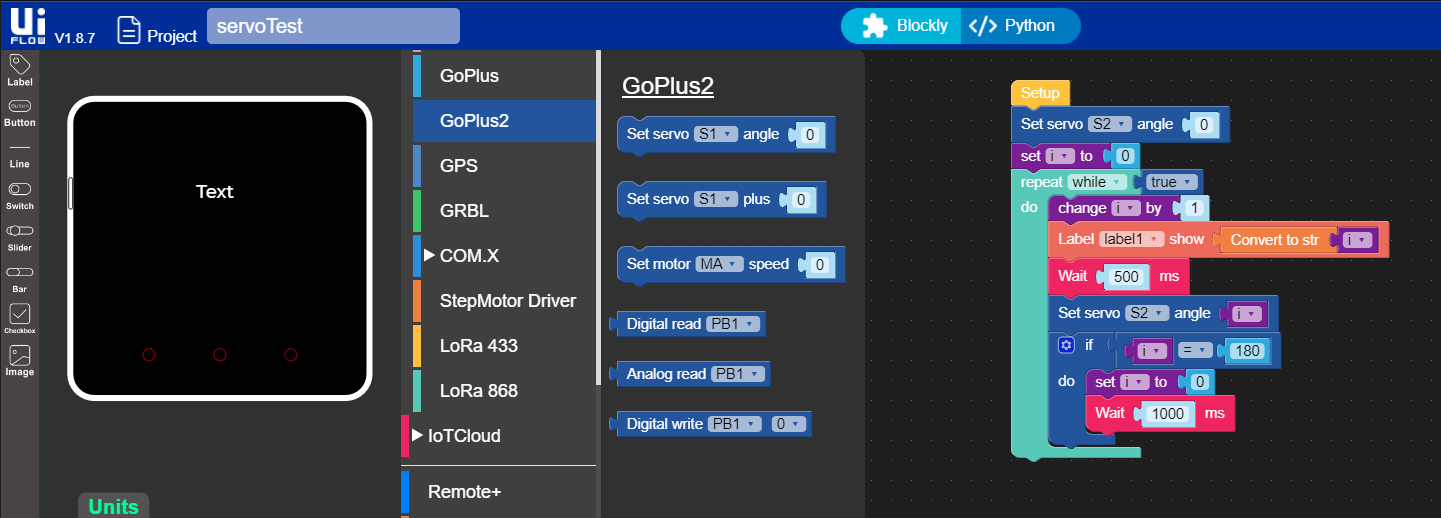

<p dir="auto">I've tried your code with UIFlow 1.8.7 and my M5Core2 (firmware 1.8.7) and M5GoPlus2 and it works as expected.</p>
<p dir="auto">Did you make sure your M5Core2 and M5GoPlus2 are firmly stacked together? Sometimes the modul's pins are a tad short and maybe not all of them make proper contact. The only other thing at this point I can think of is defective hardware.</p>
Felix</p>
<p dir="auto">P.S. I had to rebuild your code from the picture as the 'file' you posted couldn't be read by UIFlow properly.</p>

<p dir="auto">I'm using GoPlus2 (big label on the side) and program is very simple:<br />
<img src="/assets/uploads/files/1637920740788-5dbc1a03-1297-4637-bd71-df8339630bbf-image-resized.png" alt="0_1637920738918_5dbc1a03-1297-4637-bd71-df8339630bbf-image.png" class=" img-fluid img-markdown" /></p>
<p dir="auto">MD5 is as follows (can't attach)</p>
<p dir="auto">{"components":[{"id":"_coretwoscreen","createTime":1637687096589,"name":"screen","x":0,"y":0,"width":320,"height":240,"backgroundColor":"#000000","backgroundImage":"","type":"screen"},{"id":"____buttonA","createTime":1637687096589,"name":"ButtonA","buttonIndex":0,"x":35,"y":216,"width":64,"height":24,"text":"ButtonA","visibility":false,"type":"button"},{"id":"____buttonB","createTime":1637687096589,"name":"ButtonB","buttonIndex":1,"x":125,"y":216,"width":64,"height":24,"text":"ButtonB","visibility":false,"type":"button"},{"id":"___<em>buttonC","createTime":1637687096589,"name":"ButtonC","buttonIndex":2,"x":215,"y":216,"width":64,"height":24,"text":"ButtonC","visibility":false,"type":"button"},{"id":"vQLJe4OCV</em>%u2m-f","createTime":1637687307599,"isCoreTwo":true,"isPaper":false,"name":"label1","x":129,"y":42,"color":"#ffffff","text":"Text","font":"FONT_MONT_24","rotation":0,"type":"label","layer":8}],"type":"core2","versions":"Beta","units":[],"hats":[],"blockly":"&lt;variables&gt;&lt;variable id="L_m|(4}/9eWO:%!NisHe"&gt;i&lt;/variable&gt;&lt;/variables&gt;&lt;block type="basic_on_setup" id="setup_block" deletable="false" x="70" y="30"&gt;&lt;next&gt;&lt;block type="go_plus2_set_servo_angle" id="m}D<code>:c{KG33R]}RXg1/V\"&gt;&lt;field name=\"list\"&gt;S2&lt;/field&gt;&lt;value name=\"angle\"&gt;&lt;shadow type=\"math_number\" id=\"QsGvi0lK/)FFALXIgOSL\"&gt;&lt;field name=\"NUM\"&gt;0&lt;/field&gt;&lt;/shadow&gt;&lt;/value&gt;&lt;next&gt;&lt;block type=\"variables_set\" id=\"QZp~!Wkrc;aad.O7:</code>mD"&gt;&lt;field name="VAR" id="L_m|(4}/9eWO:%!NisHe"&gt;i&lt;/field&gt;&lt;value name="VALUE"&gt;&lt;block type="math_number" id=")Fa9}swif6+wjRJ]zZYg"&gt;&lt;field name="NUM"&gt;0&lt;/field&gt;&lt;/block&gt;&lt;/value&gt;&lt;next&gt;&lt;block type="controls_whileUntil" id="lDZ^V=;B;ktf51})gG,Q"&gt;&lt;field name="MODE"&gt;WHILE&lt;/field&gt;&lt;value name="BOOL"&gt;&lt;block type="logic_boolean" id="#e+UDjF=ZP*_zKi|A1=3"&gt;&lt;field name="BOOL"&gt;TRUE&lt;/field&gt;&lt;/block&gt;&lt;/value&gt;&lt;statement name="DO"&gt;&lt;block type="math_change" id="|S}G[^R}eHN.HYtHq[PZ"&gt;&lt;field name="VAR" id="L_m|(4}/9eWO:%!NisHe"&gt;i&lt;/field&gt;&lt;value name="DELTA"&gt;&lt;shadow type="math_number" id="V0Fr*{8Z(!@_2BAW2T7:"&gt;&lt;field name="NUM"&gt;1&lt;/field&gt;&lt;/shadow&gt;&lt;/value&gt;&lt;next&gt;&lt;block type="label_set_text" id="mJLH;9Yi#NH=3F`ox_c#"&gt;&lt;field name="COMPONENT"&gt;label1&lt;/field&gt;&lt;value name="TEXT"&gt;&lt;shadow type="text" id="g45]+A0%b)o%xK1=NsPX"&gt;&lt;field name="TEXT"&gt;Hello M5&lt;/field&gt;&lt;/shadow&gt;&lt;block type="convent_str" id="]uOw~L$C7g1h(|:j^vV|"&gt;&lt;value name="VALUE"&gt;&lt;block type="variables_get" id="h2=+o(mniB8nLZx9Fmr?"&gt;&lt;field name="VAR" id="L_m|(4}/9eWO:%!NisHe"&gt;i&lt;/field&gt;&lt;/block&gt;&lt;/value&gt;&lt;/block&gt;&lt;/value&gt;&lt;next&gt;&lt;block type="timer_delay_ms" id="7_S;$=2$ElNesD2!Ng?8"&gt;&lt;value name="DELAY"&gt;&lt;shadow type="math_number" id="DNPc@Zz]lRaK`D5tCPwW"&gt;&lt;field name="NUM"&gt;500&lt;/field&gt;&lt;/shadow&gt;&lt;/value&gt;&lt;next&gt;&lt;block type="go_plus2_set_servo_angle" id="`+(McF$E6N3Xp!P4LQZQ"&gt;&lt;field name="list"&gt;S2&lt;/field&gt;&lt;value name="angle"&gt;&lt;shadow type="math_number" id="{^B~OEG$3u`VL{6Q?h<em>A"&gt;&lt;field name="NUM"&gt;0&lt;/field&gt;&lt;/shadow&gt;&lt;block type="variables_get" id="}!?c}vLh:jNJMG_DzWx7"&gt;&lt;field name="VAR" id="L_m|(4}/9eWO:%!NisHe"&gt;i&lt;/field&gt;&lt;/block&gt;&lt;/value&gt;&lt;next&gt;&lt;block type="controls_if" id="kl1FQ4?cRAS_n[%z6M(x"&gt;&lt;value name="IF0"&gt;&lt;block type="logic_compare" id=".CHpi]qAHlMRug5/kIXZ"&gt;&lt;field name="OP"&gt;EQ&lt;/field&gt;&lt;value name="A"&gt;&lt;block type="variables_get" id="VE}}%{K640JGp~8o|ycr"&gt;&lt;field name="VAR" id="L_m|(4}/9eWO:%!NisHe"&gt;i&lt;/field&gt;&lt;/block&gt;&lt;/value&gt;&lt;value name="B"&gt;&lt;block type="math_number" id="v7n}ps)KNXK(6in~6op!"&gt;&lt;field name="NUM"&gt;180&lt;/field&gt;&lt;/block&gt;&lt;/value&gt;&lt;/block&gt;&lt;/value&gt;&lt;statement name="DO0"&gt;&lt;block type="variables_set" id="WobrJJD</em>K?SIveZ9SVWM"&gt;&lt;field name="VAR" id="L_m|(4}/9eWO:%!NisHe"&gt;i&lt;/field&gt;&lt;value name="VALUE"&gt;&lt;block type="math_number" id="kov:[v~_vn=Kj7imf7;3"&gt;&lt;field name="NUM"&gt;0&lt;/field&gt;&lt;/block&gt;&lt;/value&gt;&lt;next&gt;&lt;block type="timer_delay_ms" id="lG5Q^c;@:H=;`},HDqs="&gt;&lt;value name="DELAY"&gt;&lt;shadow type="math_number" id="FUtp2)JEwql6hgOs1{(."&gt;&lt;field name="NUM"&gt;1000&lt;/field&gt;&lt;/shadow&gt;&lt;/value&gt;&lt;/block&gt;&lt;/next&gt;&lt;/block&gt;&lt;/statement&gt;&lt;/block&gt;&lt;/next&gt;&lt;/block&gt;&lt;/next&gt;&lt;/block&gt;&lt;/next&gt;&lt;/block&gt;&lt;/next&gt;&lt;/block&gt;&lt;/statement&gt;&lt;/block&gt;&lt;/next&gt;&lt;/block&gt;&lt;/next&gt;&lt;/block&gt;&lt;/next&gt;&lt;/block&gt;","Blockly.Remotes":[],"Blockly.RemotePlus":[{"id":"__title","blockId":"","createTime":1637920356349,"name":"M5RemoteTitle","dragAndDrop":false,"resizable":false,"options":{"minWidth":1,"minHeight":1,"maxWidth":6,"maxHeight":10,"defaultWidth":2,"defaultHeight":1},"w":2,"h":1,"bgColor":"#0080FF","color":"#fff","fontsize":"M","label":"M5Remote","type":"title","x":0,"y":0}],"modules":[]}</p>
