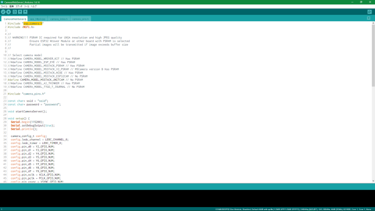

<p dir="auto">I use UNIT CAMERA DIY KIT.<br />
I tested it with the latest cameraWebServer sample program.<br />
I got the same error, so I checked the source program.<br />
I found the following description in the comment of esp_camera.h.</p>
<p dir="auto">typedef enum {<br />
CAMERA_FB_IN_PSRAM, / *! &lt;Frame buffer is placed in external PSRAM * /<br />
CAMERA_FB_IN_DRAM / *! &lt;Frame buffer is placed in internal DRAM * /<br />
} camera_fb_location_t;</p>

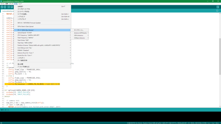

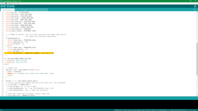

<p dir="auto">I added one line to the cameraWebServer program as a trial.</p>
<p dir="auto">// if PSRAM IC present, init with UXGA resolution and higher JPEG quality<br />
// for larger pre-allocated frame buffer.<br />
if (psramFound ()) {<br />
config.frame_size = FRAMESIZE_UXGA;<br />
config.jpeg_quality = 10;<br />
config.fb_count = 2;<br />
} else {<br />
config.frame_size = FRAMESIZE_SVGA;<br />
config.jpeg_quality = 12;<br />
config.fb_count = 1;<br />
config.fb_location = CAMERA_FB_IN_DRAM; // add 2021-12-09<br />
}</p>

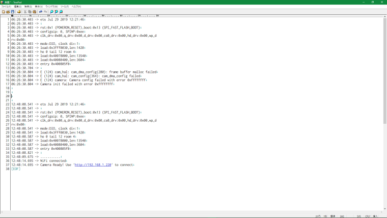

<p dir="auto">I checked the operation of UNIT CAM.</p>
<p dir="auto">12: 48: 08.541-&gt; ets Jul 29 2019 12:21:46<br />
12: 48: 08.541-&gt;<br />
12: 48: 08.541-&gt; rst: 0x1 (POWERON_RESET), boot: 0x13 (SPI_FAST_FLASH_BOOT)<br />
12: 48: 08.541-&gt; configsip: 0, SPIWP: 0xee<br />
12: 48: 08.541-&gt; clk_drv: 0x00, q_drv: 0x00, d_drv: 0x00, cs0_drv: 0x00, hd_drv: 0x00, wp_drv: 0x00<br />
12: 48: 08.541-&gt; mode: DIO, clock div: 1<br />
12: 48: 08.541-&gt; load: 0x3fff0030, len: 1420<br />
12: 48: 08.587-&gt; ho 0 tail 12 room 4<br />
12: 48: 08.587-&gt; load: 0x40078000, len: 13540<br />
12: 48: 08.587-&gt; load: 0x40080400, len: 3604<br />
12: 48: 08.587-&gt; entry 0x400805f0<br />
12: 48: 08.821-&gt;<br />
12: 48: 09.675-&gt; ...........<br />
12: 48: 14.695-&gt; WiFi connected<br />
12: 48: 14.695-&gt; Camera Ready! Use'<a href="http://192.168.1.220" target="_blank" rel="noopener noreferrer nofollow ugc">http://192.168.1.220</a>' to connect</p>
