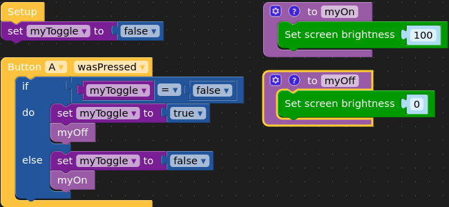

<p dir="auto">I cannot reproduce your issue with my M5StickCPlus. I toggled brightness on/off about 100 times without it locking up.<br />
Here is my UIFlow 1.8.7 blockly:</p>
<p dir="auto"><img src="/assets/uploads/files/1638371820947-uiflow187_m5stickcplus_brightnesstoggle_211201.png" alt="0_1638371819498_UIFlow187_M5StickCPlus_BrightnessToggle_211201.png" class=" img-fluid img-markdown" /></p>
<p dir="auto">Thanks<br />
Felix</p>

<p dir="auto">Create a function called "ScreenOff" that contains just the command "Set Screen Brightness 0". Create a second function called "ScreenOn" that contains the command "Set Screen Brightness 100." Try calling them a few times.</p>
<p dir="auto">I've literally reduced the code to that, where the functions alternate on button A press. It locks up within the first ten calls.</p>
<p dir="auto">By adding LED On before the screen brightness call, and adding LED Off immediately after, I can see that the LED goes on and stays on when the stick locks up, indicating that it's failing directly on the Set Screen Brightness call. Once the stick is locked, it has to be reset with both side buttons before new code can be loaded.</p>
]]></description><link>https://community.m5stack.com/post/15675</link><guid isPermaLink="true">https://community.m5stack.com/post/15675</guid><dc:creator><![CDATA[Devilstower]]></dc:creator><pubDate>Wed, 01 Dec 2021 14:55:27 GMT</pubDate></item><item><title><![CDATA[Reply to Calls to &quot;Set Screen Brightness&quot; generate a lockup on M5StickC on Tue, 30 Nov 2021 20:18:12 GMT]]></title><description><![CDATA[<p dir="auto">Hello <a class="plugin-mentions-user plugin-mentions-a" href="/user/devilstower" aria-label="Profile: Devilstower">@<bdi>Devilstower</bdi></a></p>
